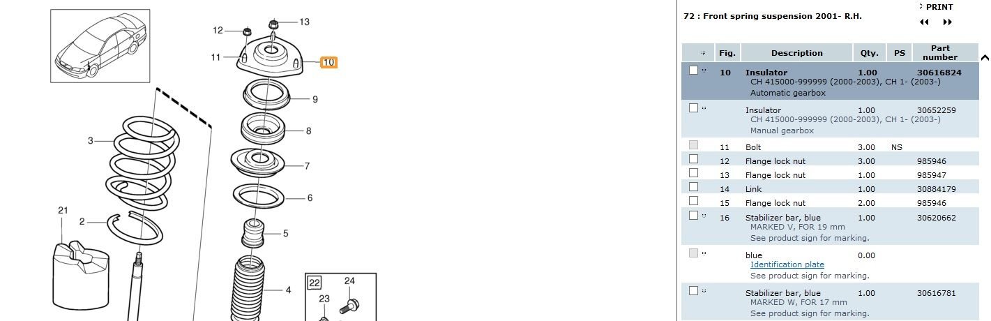

Gen 1 S40s are also prone to breaking springs - look closely at the last 3 inches or so of both ends. Also should the spring break off an end, the misalignment could damage the strut mount. you should be able to see the spring by turning to full lock
Old Jan 21, 2021 | 11:45 AM
Might have a broken strut mount - similar in design to the other FWD Volvos and make a lot of noise when the rubber breaks, Easy to test - if you can turn the nut at the top of the strut - the mount is broken. Careful compressing the spring - the S40 front springs don't compress easily with your run of the mill hand held compressor. They have a funny shape and don't compress linearly (in a straight line)
Old Jan 21, 2021 | 03:54 PM
Likes: 540
plus the mount needs to align correctly. Springs are very long and as hoonk noted, standard compressors don't work very well.
