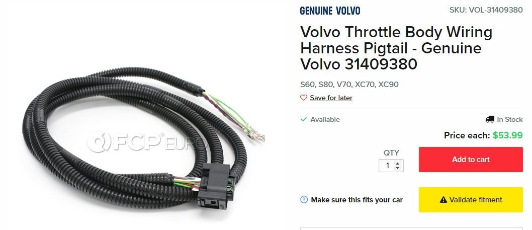

A common problem for some Volvos around that year related to idle - is the connections at the throttle module. Volvo developed a replacement harness to hopefully solve those idle/running problems. Sold as either the complete wiring back to the ECM or as solder in pigtails.
