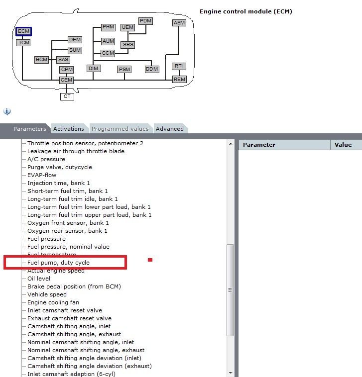

Did you clear the codes or are you just waiting for it to go off by itself?
What is the duty cycle on the fuel pump?

I’m not entirely sure what the duty cycle is.
Duty cycle is roughly the percentage of time the fuel pump runs. Value too high = a code. A compatible scan tool can read that value.

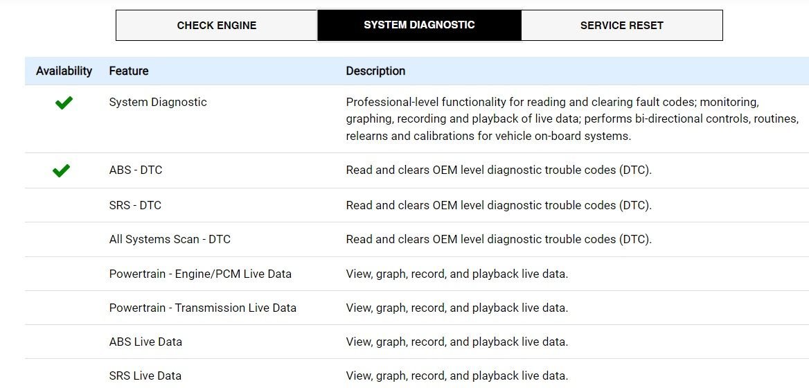

I have a Innova 3030rs scanner it is compatible to scan my vehicle, I’m not sure what else I need
Old Oct 1, 2023 | 11:08 AM
Hopefully it can display fuel pump duty cycle in live data.
