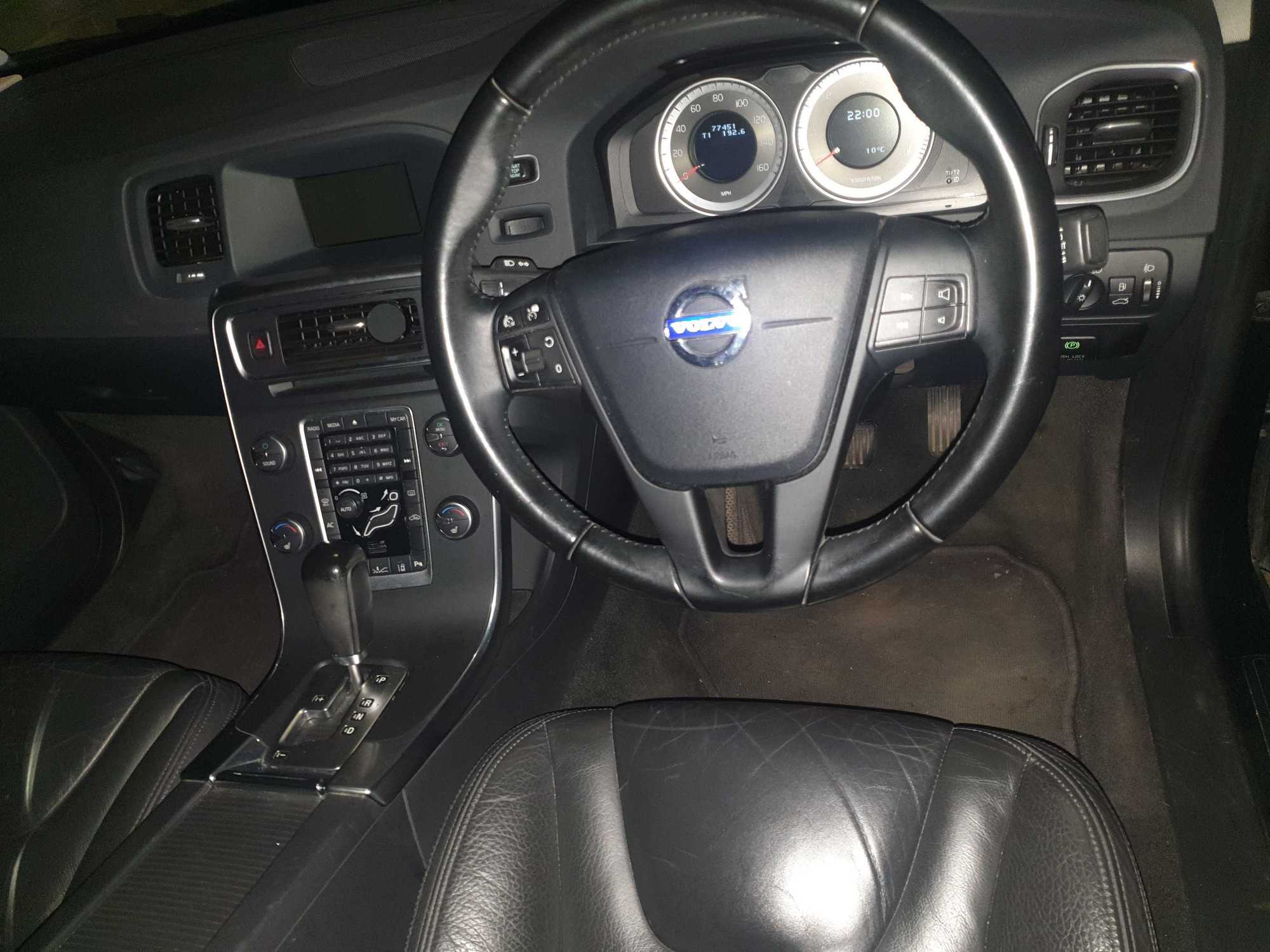

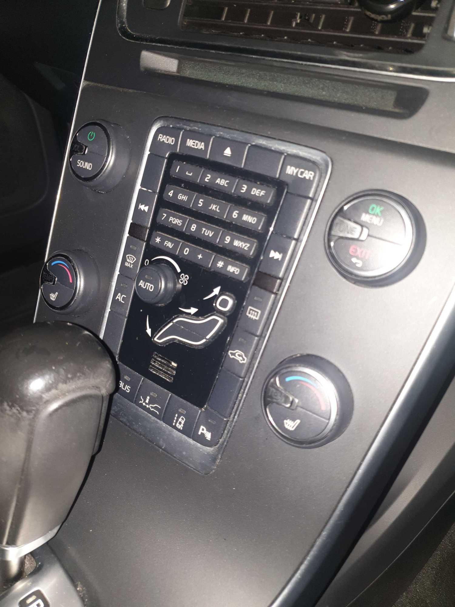

Can I change the HeadUnit from my car with another one that has BlueTooth and Navigation? See attched photos of my car's buttons.
As you can see, the buttons for managing calls are not on the steering wheel and the Navigation button is missing from the HeadUnit.
I found this for sale on eBay and I'm considering buying it to see if it can be swapped with mine.
Would also mean I need to change the steering wheel buttons to be able to answer calls. Probably this would work - need to see the exact part number.

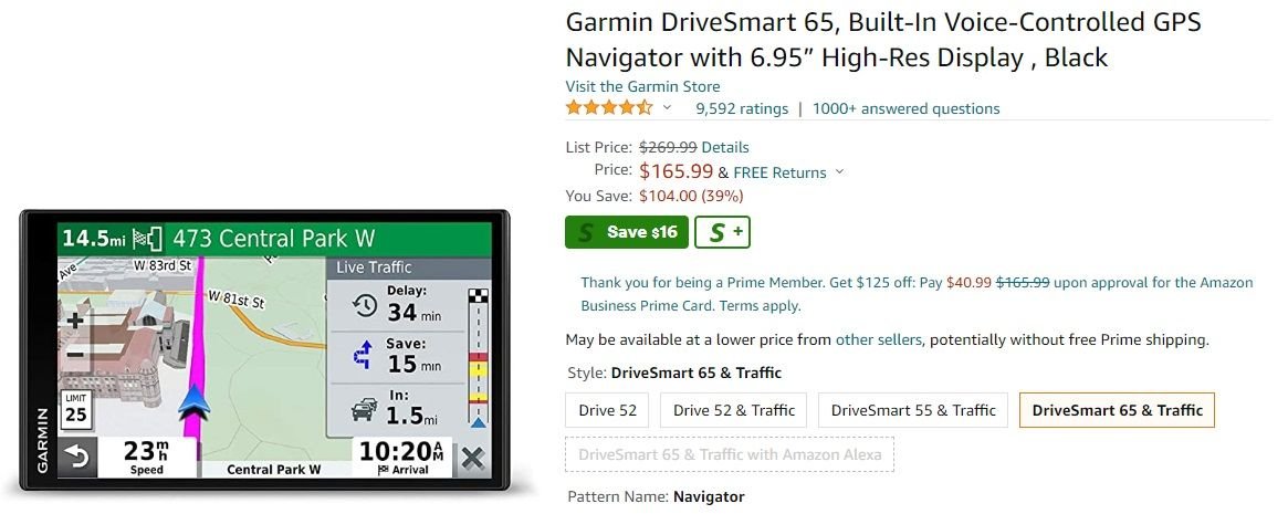

Volvo's solution back from their parts catalog is below at the bottom - a Garmin 3790 -
Unfortunately your other choice is something like this Nav with bluetooth. That garmin will perform better (with traffic info also) and be easier to use than the factory installed Nav system. Map updates will be free, unlike Factory systems which tend to have NO updates available after x years. I'm certain you could find something similiar in your part of the world. Sorry - I looked into simply adding factory bluetooth to a 2010. (I've worked on Volvos at my shop for 40 years) I sold the car and bought a 2015 that had it factory installed.
