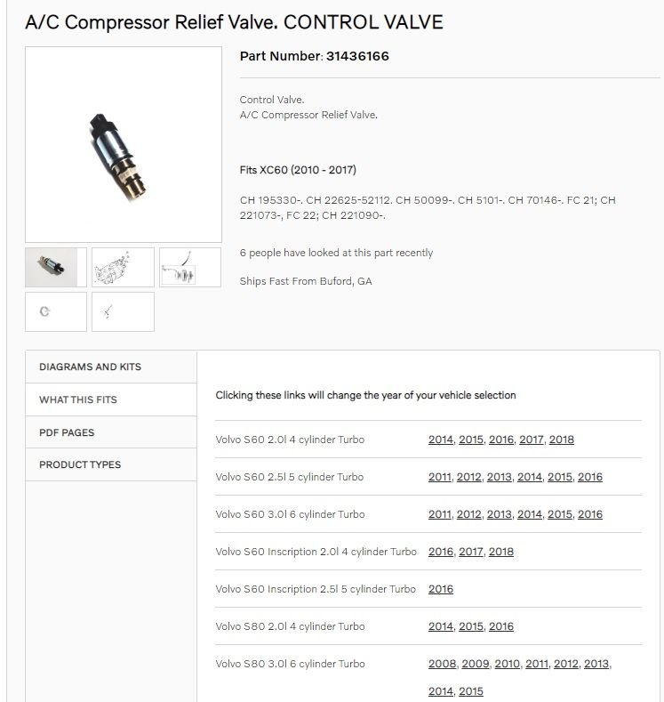

So - unless you have a variable displacement compressor - it will suck in whatever you give it. Not sure about a 2017 - but the earlier 6 cyl Volvos and other brands have variable displacement compressors. Some VWs don't even have a clutch - the compressors are "turned off" by moving the swash plate so the compressor pistons don't move instead of a electric clutch.
Does your compressor have a valve in the side of the compressor such as pictured below? - more than 1 set of wires going to the compressor? If so you have a variable displacement compressor and it is common for the valve to get clogged or go bad. Then the swash plate does not move when it is supposed to and the compressor won't suck or pressurize and - it's not cold in the car!
If using an ac machine - modern ones measure the freon being pulled out. If it had x grams in it you will know is was properly charged and can based your next diagnosis with that information. So if it pulls out close to x grams and you put in x grams freon you will get the same result - no cold air (unless what was in there was contaminated with air - easy for a DIY to make that mistake) Could be a bad displacement valve (if equipped)
