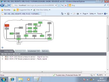

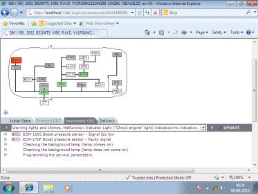

Default Got Dice/Vida working...error codes:
This shows the boost pressure sensor is low/bad signal.
A MAP sensor could possibly be at fault...what's the best easiest way to check...is there extra tests I can do with the software or clean or replace sensors???
