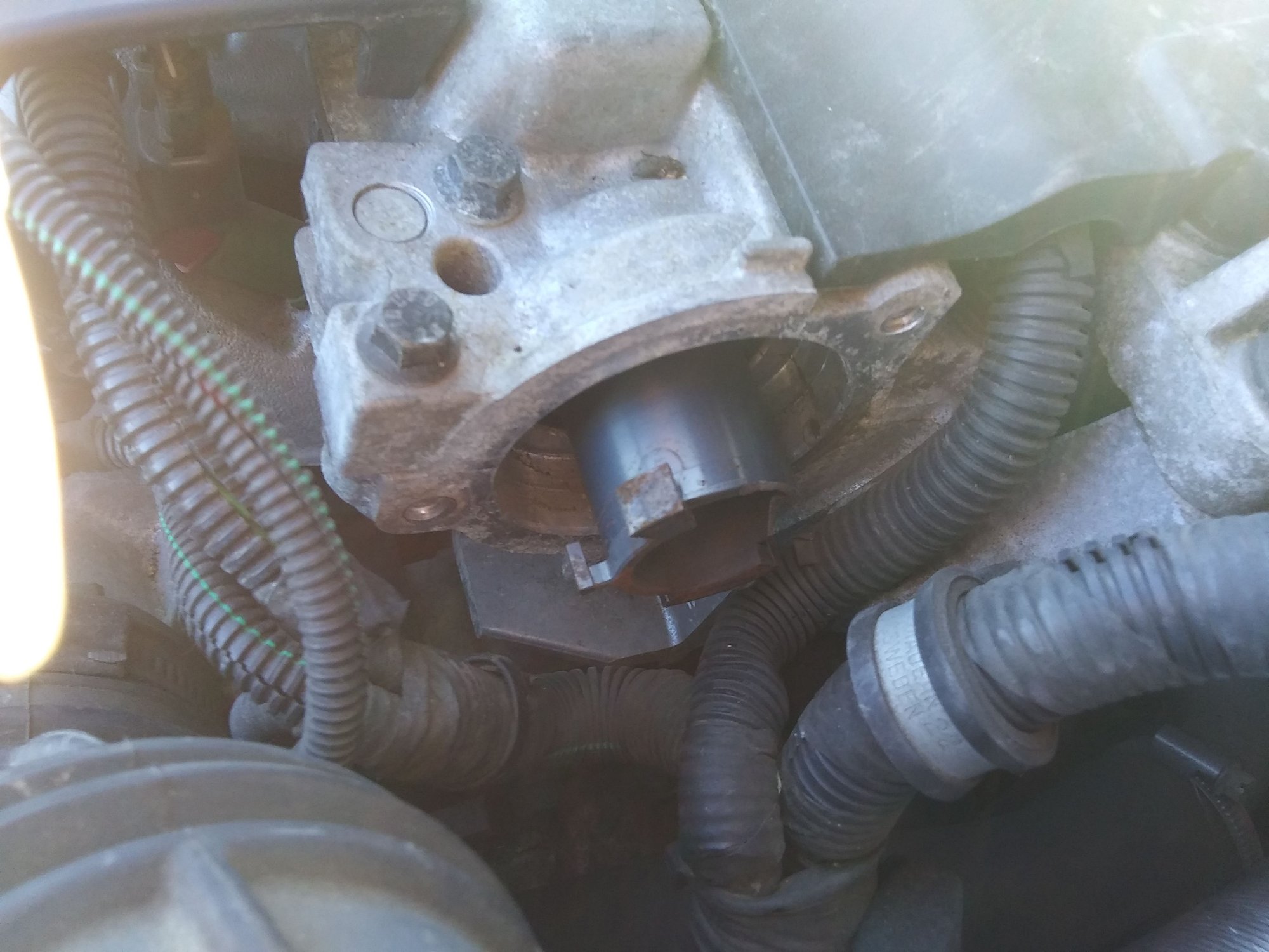

Does anyone know the name of that metal piece that spins that sits behind the camshaft pos sensor housing? Mines chipped and I think that's what keeping my car from continually running when started. Volvo s60 2003. If it's easily replaced I rather fix it myself.

something like this?
https://parts.volvocarsannapolis.com...IaApP2EALw_wcB

Does anyone know if replacing the aperture is as easy as it looks? Is it just a unscrew it and screw a new one in situation r is there more to it?

That’s it - one bolt, only fits one way
