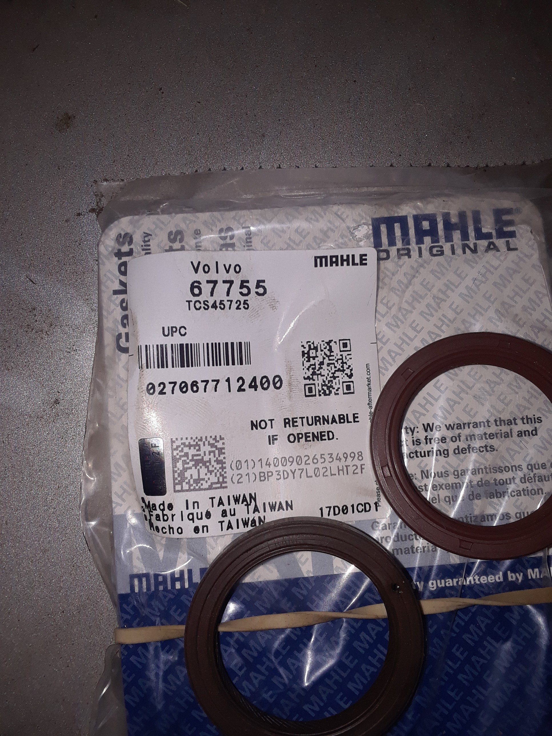

I don't know what happened, but I ordered a victor reinz seal from rock auto and they sent me this seal. It does say victo reinz on the packaging somewhere. I truly thought I would get an oem seal. I had to learn the hard way again. I have never had an issue with oem, but aftermarket is a nightmare sometimes.

I've always been in the habit of changing the seals when i'm in there. It is amazing the quality of the seals they use though. I've never seen a seal that pliable with that much mileage on it. Everything is manufactured to a higher standard on this vehicle than what i'm used to.
I got it done today. I used an aisin pump, the gates kit and that damn taiwanese front crank seal. I hope to never have to do cam seals on this car, just because I don't want to buy the cam lock tool. I'm not sure what you mean by specialty shop, but i'm going to search for them just to see how hard the o rings are to find.
