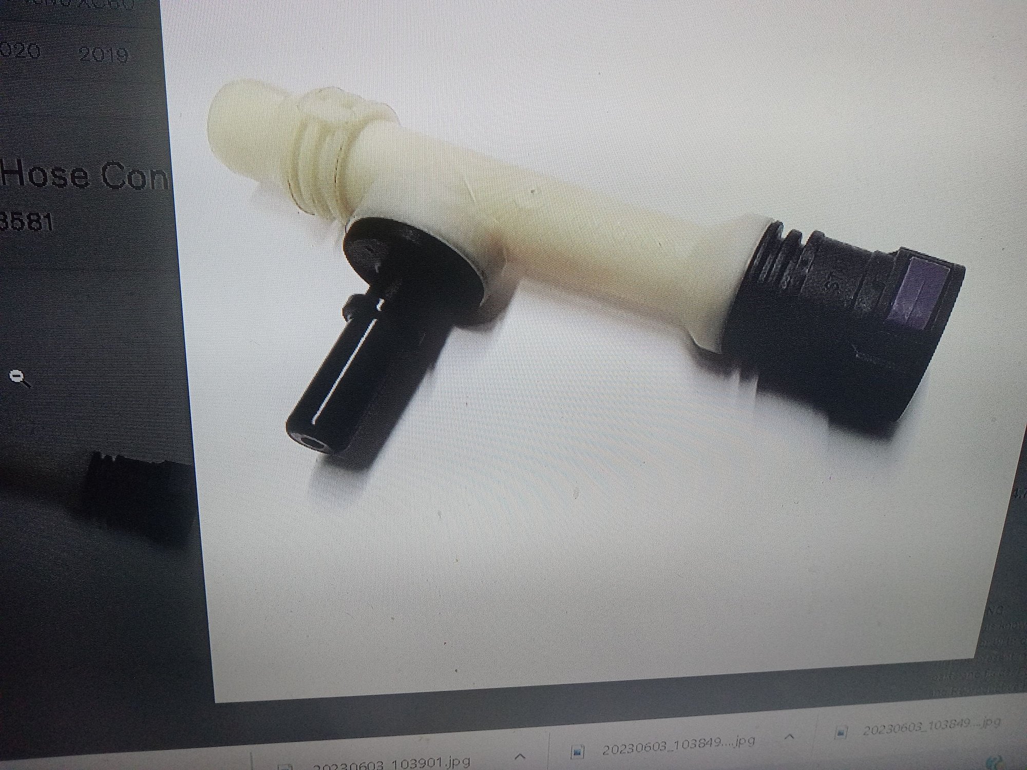

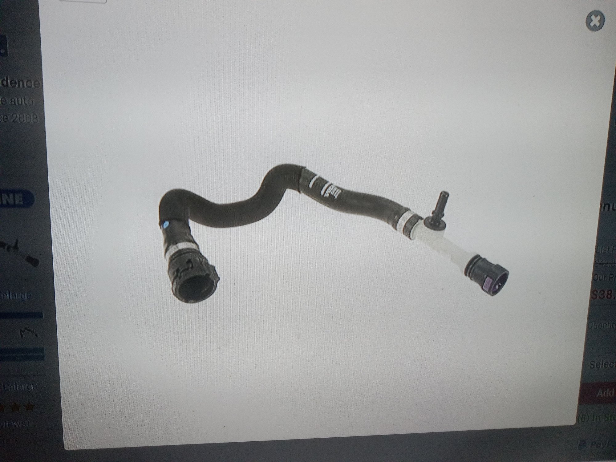

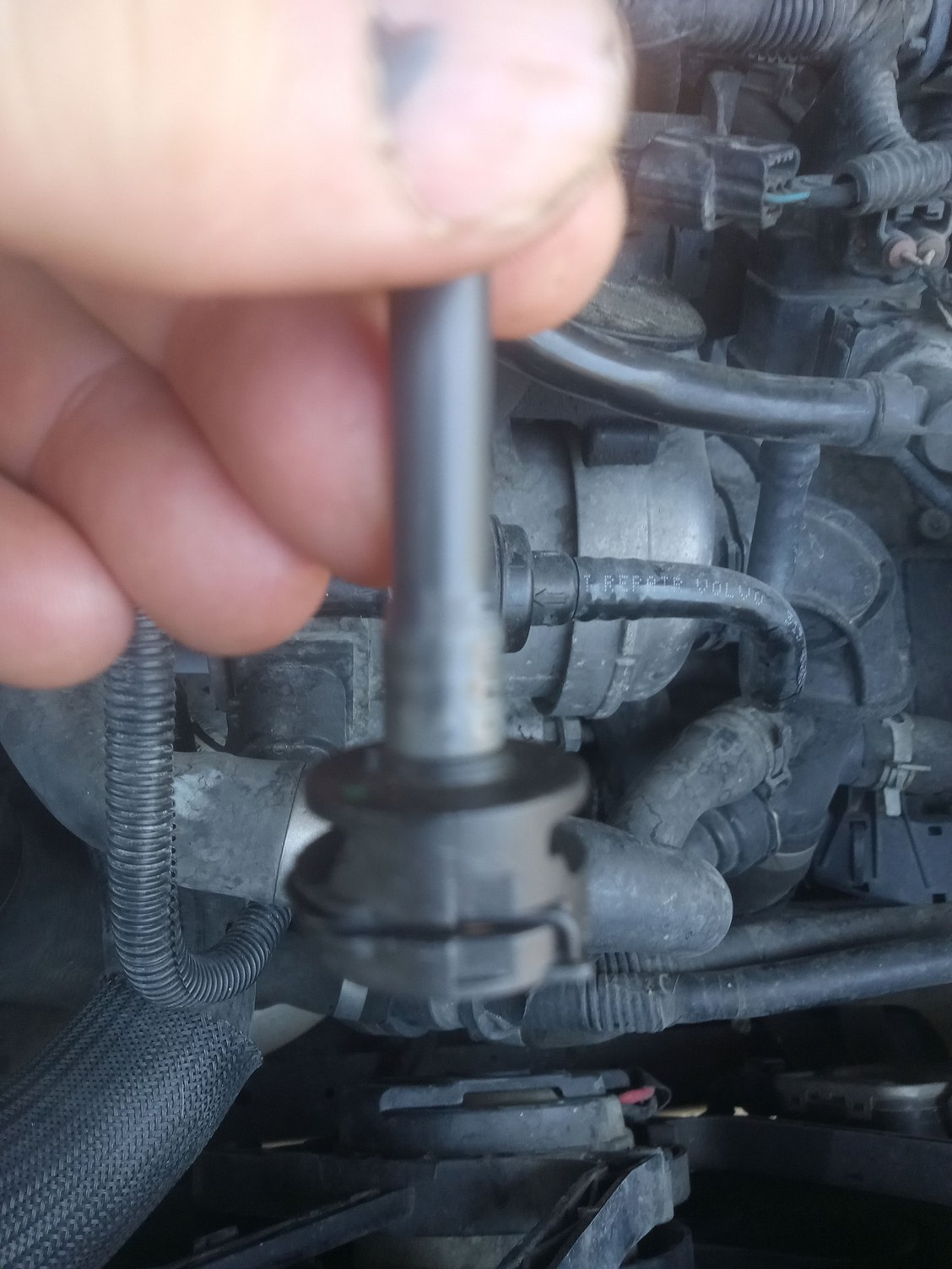

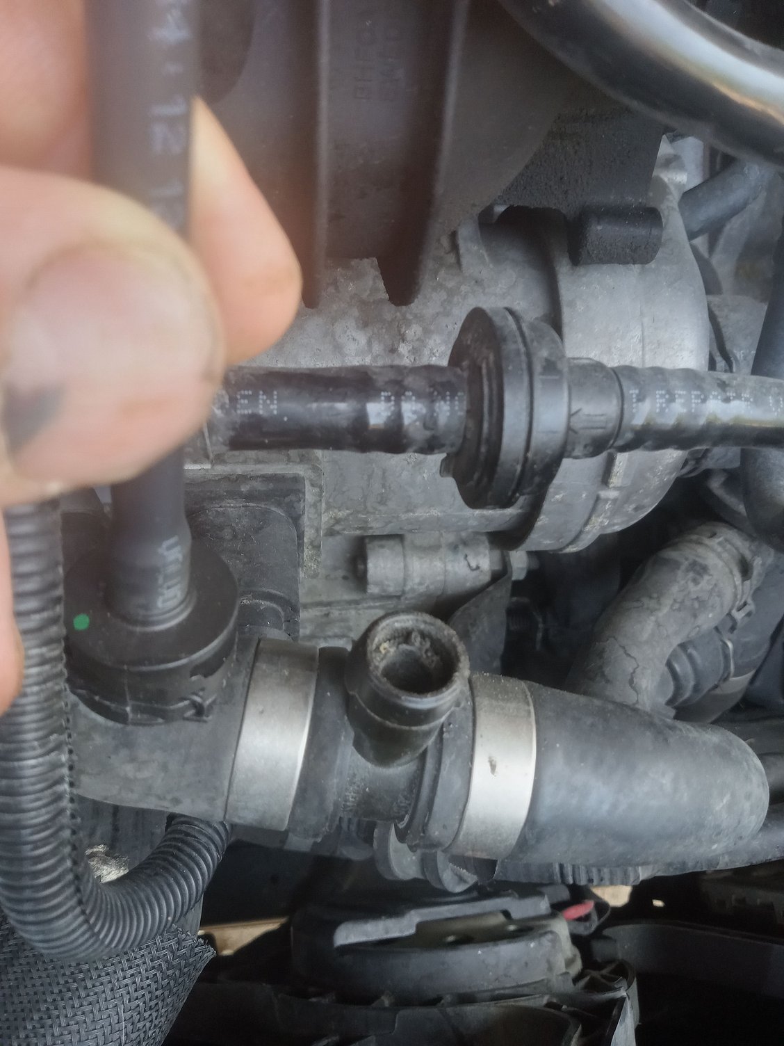

long story but i had to replace the heater coolant feed on my 2015 s60, the new hose came with a different connector, one of the round quick connect with the wre clip, my old connecter you just pushed in the the heater hose connector and pinched the tabs on each side till far enough the ears would bite in the radiator hoses. . the round connector i dot think will work with the adapter present? the dealership has tried but has not been able to provide assistance i feel confident in.. first they told me i need the adapter with the long hose on it, then yesterday they told me i needed to purchase the manifold that comes off the water pump and it would come with all the hoses etc plus more i dont need apparently for nearly $250
i am completely lost as what to do at this point other than have the car towed and end up paying 6 or700 dollars for a couple of hoses being put on... any experience you can share with me will be appreciated.

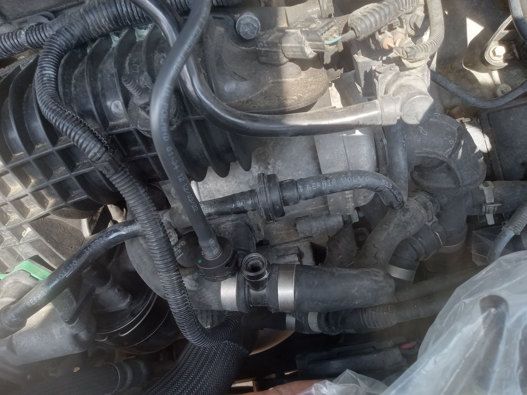

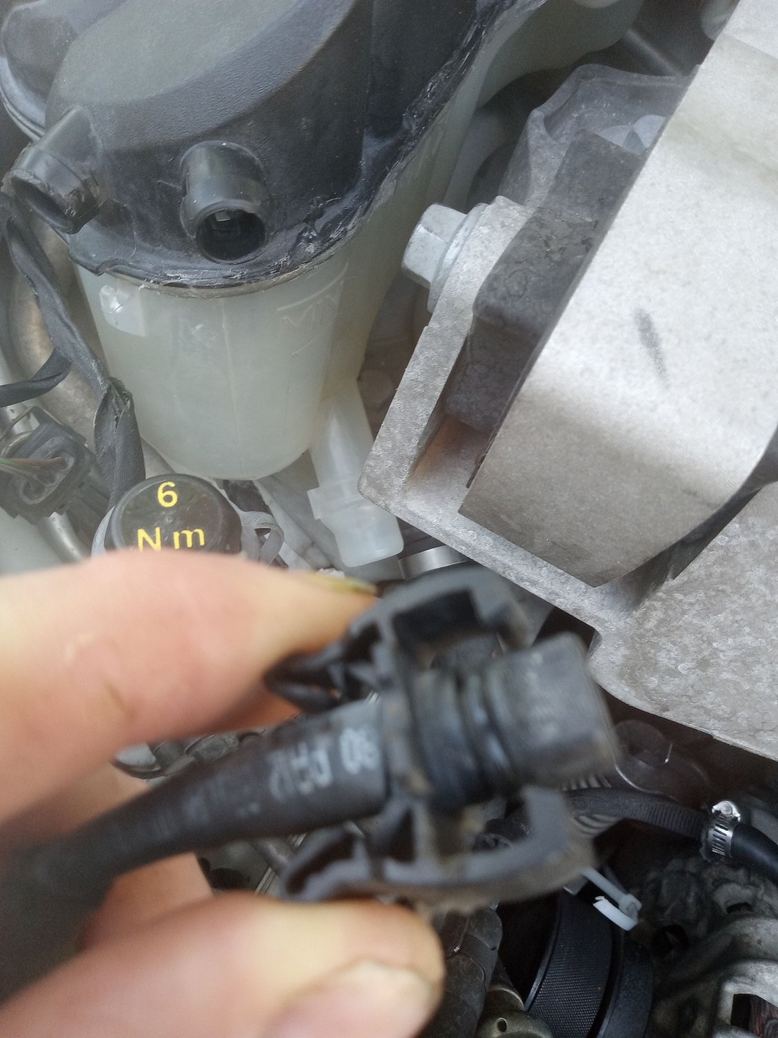

original connector on heater core feed
original connector pushed into this adapter fitting letting the clips on the original fitting catch under the fitting
left side hole going into block` 5in
right side hose going into the water pump manifold,,~ 7in
the new connector

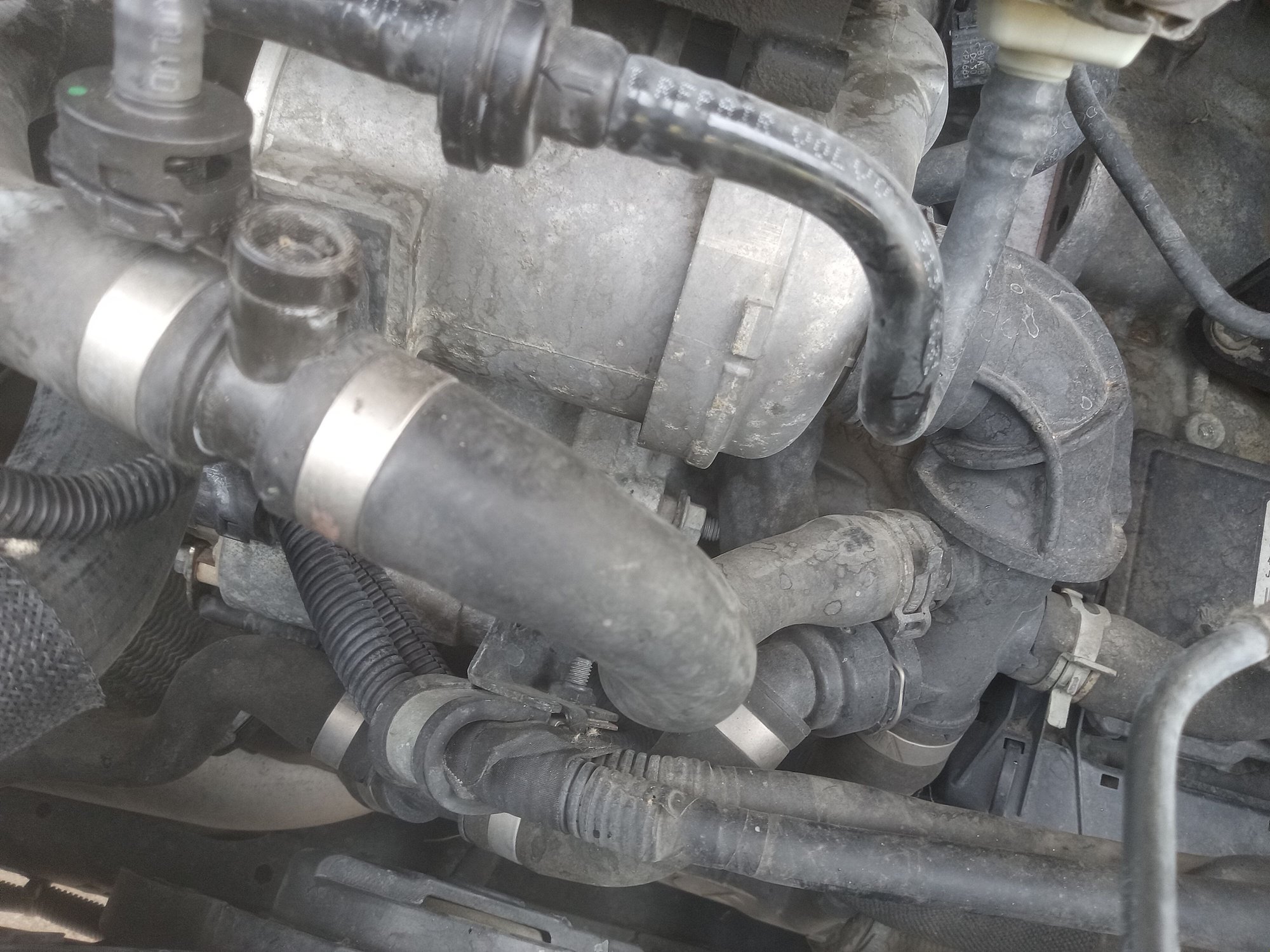

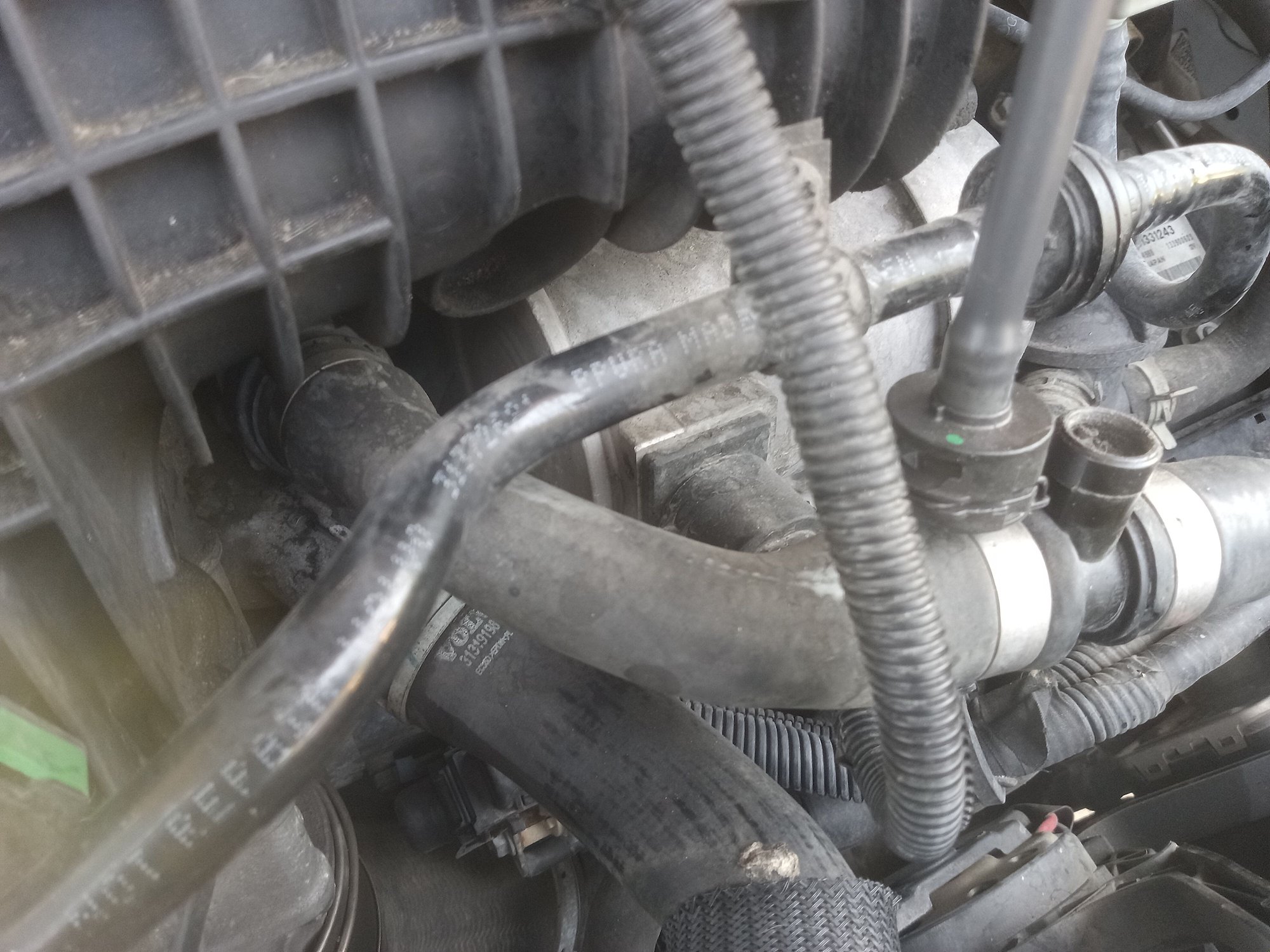

over all view of the radiator hose and hater hose
listing for heater hose adapter to line up the adapter the long end of the hose would be like 9 ot 10 inches rather than the 7 ' then what to do for the hose to the other side
just the adapter by itself, does anyone know the part number for the hoses that would connect to this?

i had to replace the heater coolant feed on my 2015 s60, original connector on heater core feed

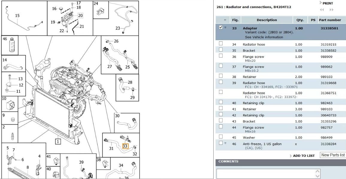

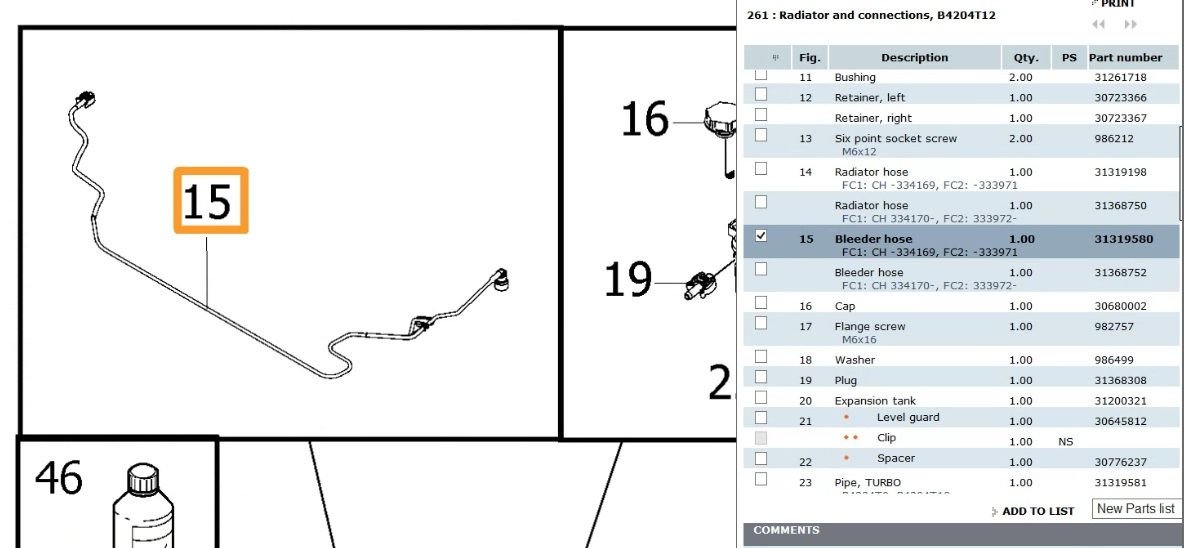

If the hose you are seeking is illustrated by your first two photos - With one end on the coolant reservoir and the other with that round connector - That I would not call a "heater coolant feed" hose. I would call that an air bleed hose - it's purpose to to let any trapped air out into the coolant bottle. You might need the part #15 below. Note there is a VIN and factory (where the car was built) break. The light colored plastic adapter you pictured is related to the heater hoses - and it's probably #33. Perhaps your part source is being confused by what you are calling your desired part.
