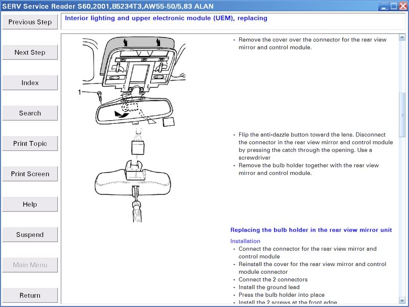

tech's Avatar
Joined: Sep 2004
Posts: 36,349
Likes: 46
Default RE: Even Volvo dealer techs can't answer this?!

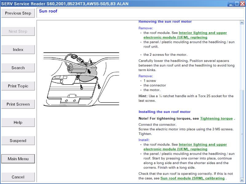

Old Jul 12, 2008 | 09:27 PM
tech's Avatar
Joined: Sep 2004
Posts: 36,349
Likes: 46

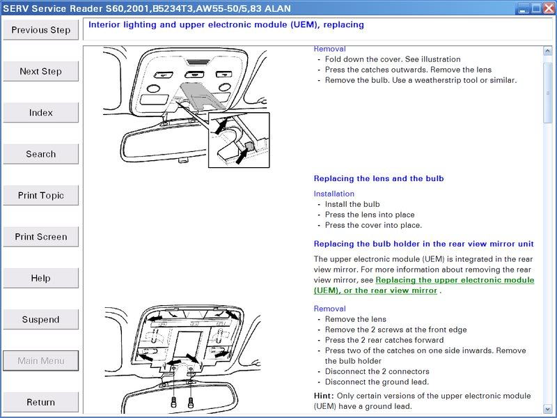

Old Jul 12, 2008 | 09:28 PM
tech's Avatar
Joined: Sep 2004
Posts: 36,349
Likes: 46
Old Jul 12, 2008 | 09:29 PM
tech's Avatar
Joined: Sep 2004
Posts: 36,349
Likes: 46
Once you get it apart leave the mirror connected. Drop motor out leaving the glass in the full closed position.
tech's Avatar
Joined: Sep 2004
Posts: 36,349
Likes: 46
Then move the switch till it stops. Then make sure when you press it again it will go into the tilt position. Then bring it back down and reinstall the motor.
