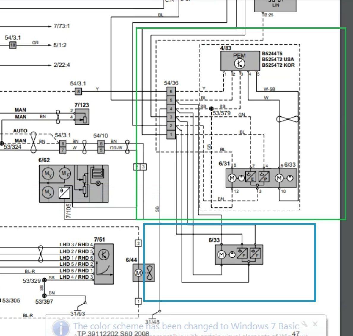

Hi all. I am new here, trying to trace my fuel pressure issues using the wiring diagram. Could someone please help me understand what the "M", "P", and "E" symbolize? Thanks!
Old Jan 24, 2025 | 09:51 AM
M is the fuel pump motor - P and E are the left and right fuel level senders.
That diagram is for a car that does not have a fuel pressure sensor on the end of the fuel rail - and as such does not have a fuel pump controller, or also known as a PEM.

Thanks hoonk. The PEM is found throughout the wiring diagram I have. I already replaced it, to no avail, since it is a cheap fix.
It's odd. No pressure at rail and fuel filter. But I can hear pump activity. Not going to throw parts at it. Need to trace the issue.
Wiring from Volvo includes with and without PEM
Green box - with Pem
Blue box - without
