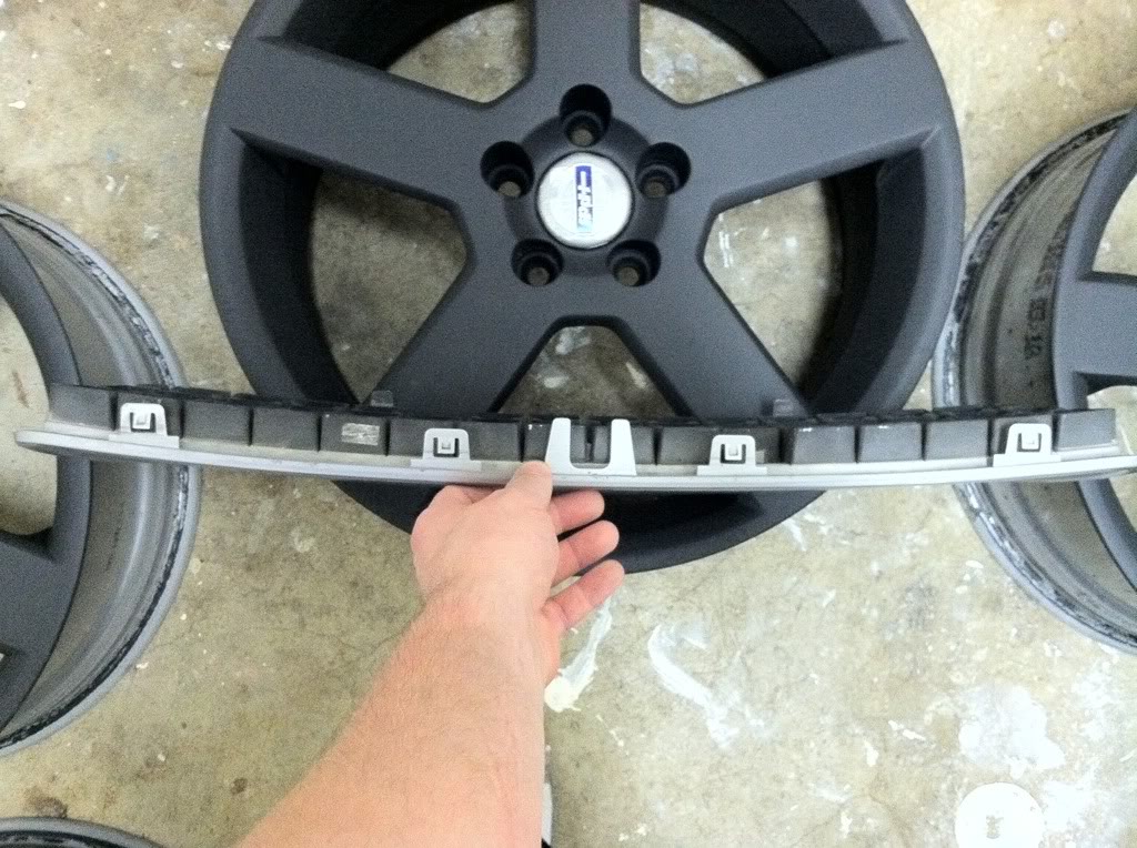

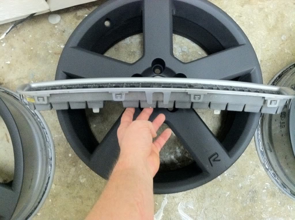

This is an S60R grill so the design in slightly different but the mounting tabs are all in the same general if not exact location and the slash mounts the same way with all the "egg crate" style grills. There are no clips in the sides, just the the guiding tabs that you see in the center of the top and bottom of the grill.
You can see how the slash mounts in those locations.
Top side clips
Bottom side clips
