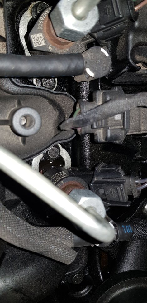

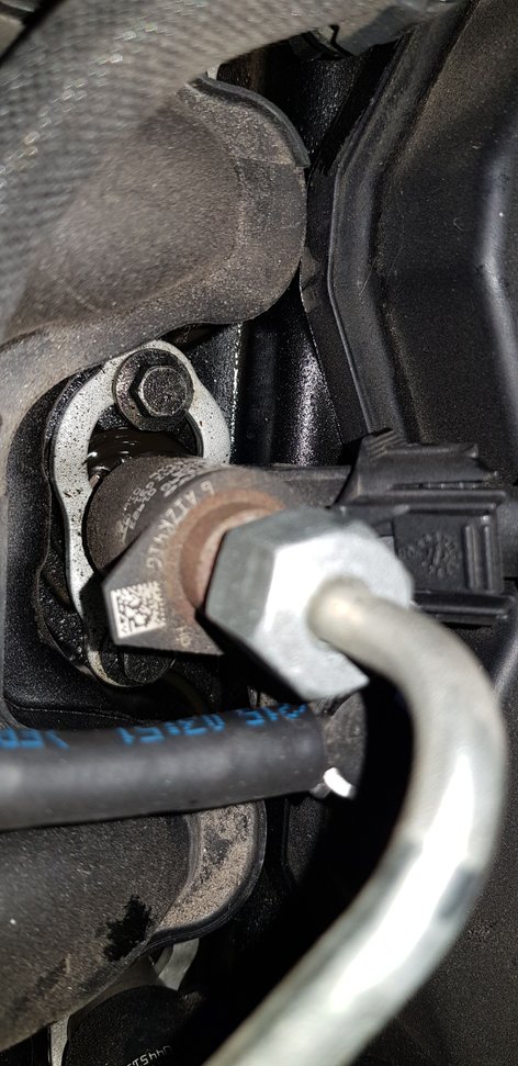

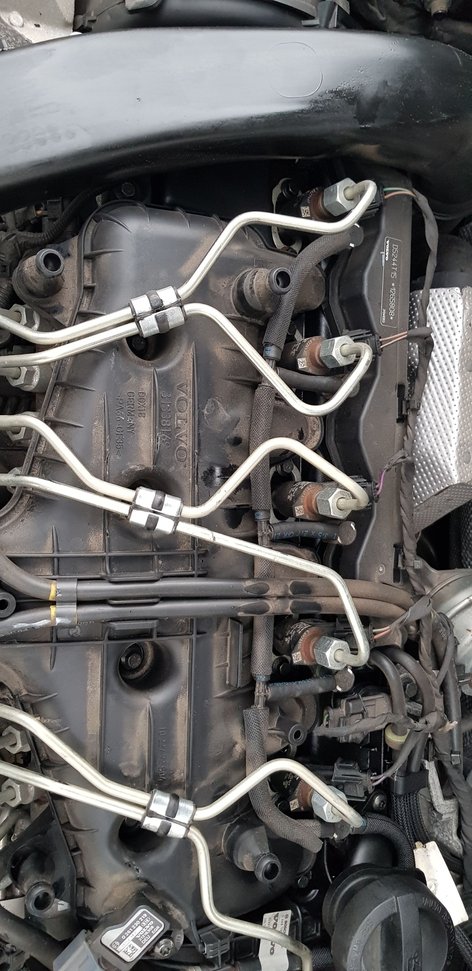

V60 D5 2013 55k miles.
Noticed injectors sitting in oil. Dipped paper towel to make sure, no diesel smell and consistant with oil.
oil level ok changed recently (castrol).
car runs great no warning lights or performance change.
uploaded fotos.
All injectors affected and no oil dripping from engine.
am kind of shocked, its my first ever volvo. So far it had a radiator failure, and now the screenwash reservoir is cracked.
and now this. Not happy.
please advise.

Recent oil change = Spilled oil when filling?
Oil fill cap pad gasket seeping?
Valve cover gasket?
Clean the oil from the engine and try to track the leak source on a clean engine.

Oil level steady. I cant track a concrete source. The oil cap is defometly not weeping. Took cover off and revved it there was no movement in the onjector well and no bubbles. As much as i can see and feel, the is no oil around the rocker cover.
am just a bit stunned to be honest. How likely is it to be the gasket given the year and mileage of the car? Id expect to see such a thing on an older car,witj 100+k miles at least.
