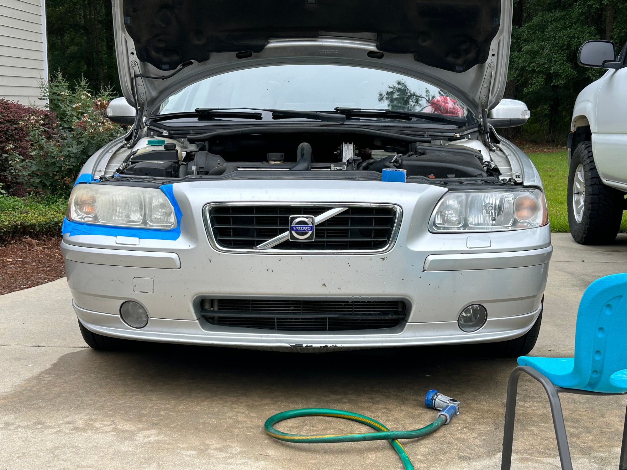

After reading this thread I decided to buy the Sylvania kit for my 2008 S60. 1 kit was enough to do both headlights and fog lights. It didn’t make them look like brand new, but it made a big difference. In this pic the drivers lights were complete and passengers hadn’t been touched.
