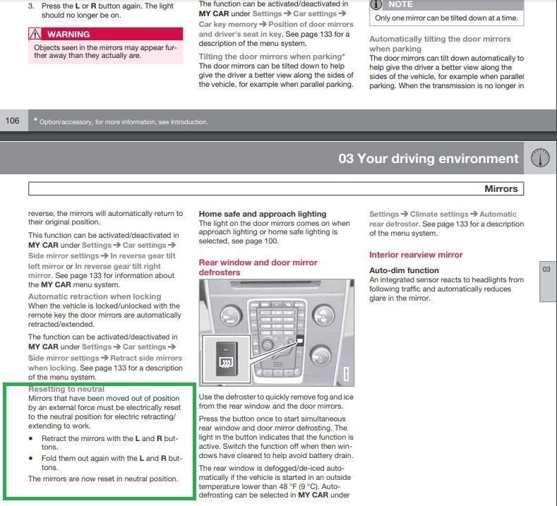

Hi guys. Got a 2012 s60 here. The passenger side mirror glass fell out so I ordered replacement glass. Got it installed with no issues (so I thought). But now when I put it in reverse the parking assist feature doesn't aim the mirror down towards the curb correctly. I tried manually adjusting the mirror with my hand while it was in reverse (thought aiming it myself would set the correct aim) but not the mirror barely moves when I put it in reverse. If I adjust it from the driver side controls it moves fine so I think the motor is fine. Any ideas?

Did you manually push the mirror out of position when replacing the glass? if so you might need to reset the mirrors (by manually folding and unfolding)

Honestly I didn't e en know the mirrors folded in. 😅 I'll give it a try this evening when my daughter get home. Thank you for the reply!

Now that I read this I'm pretty sure the car doesn't have motorized retractable mirrors. You can adjust the mirror position from inside the car but the whole mirror doesn't fold into the side of the car. Not sure if this applies.
