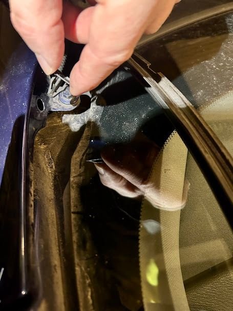

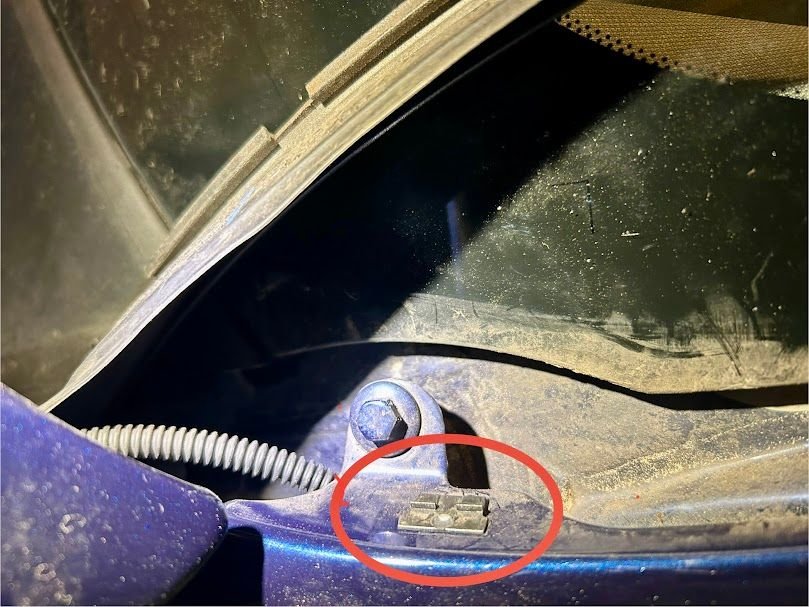

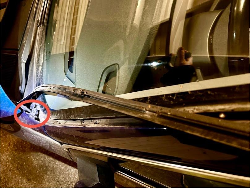

Also my rattle is gone now, such a relief! Thanks to your tips I started looking at the exterior weather strip and BINGO, the clip on the lower end was apparently broken and by sitting loose there it could rattle. See pictures, it is the one in the red ring. When I gently tapped it with my finger, I could clearly hear the sound it made, just like a loose pastic piece against a hollow metal piece would in higher speeds and forced by wind. I removed this lower clip, put everything else together again and now I can enjoy a silent ride.
