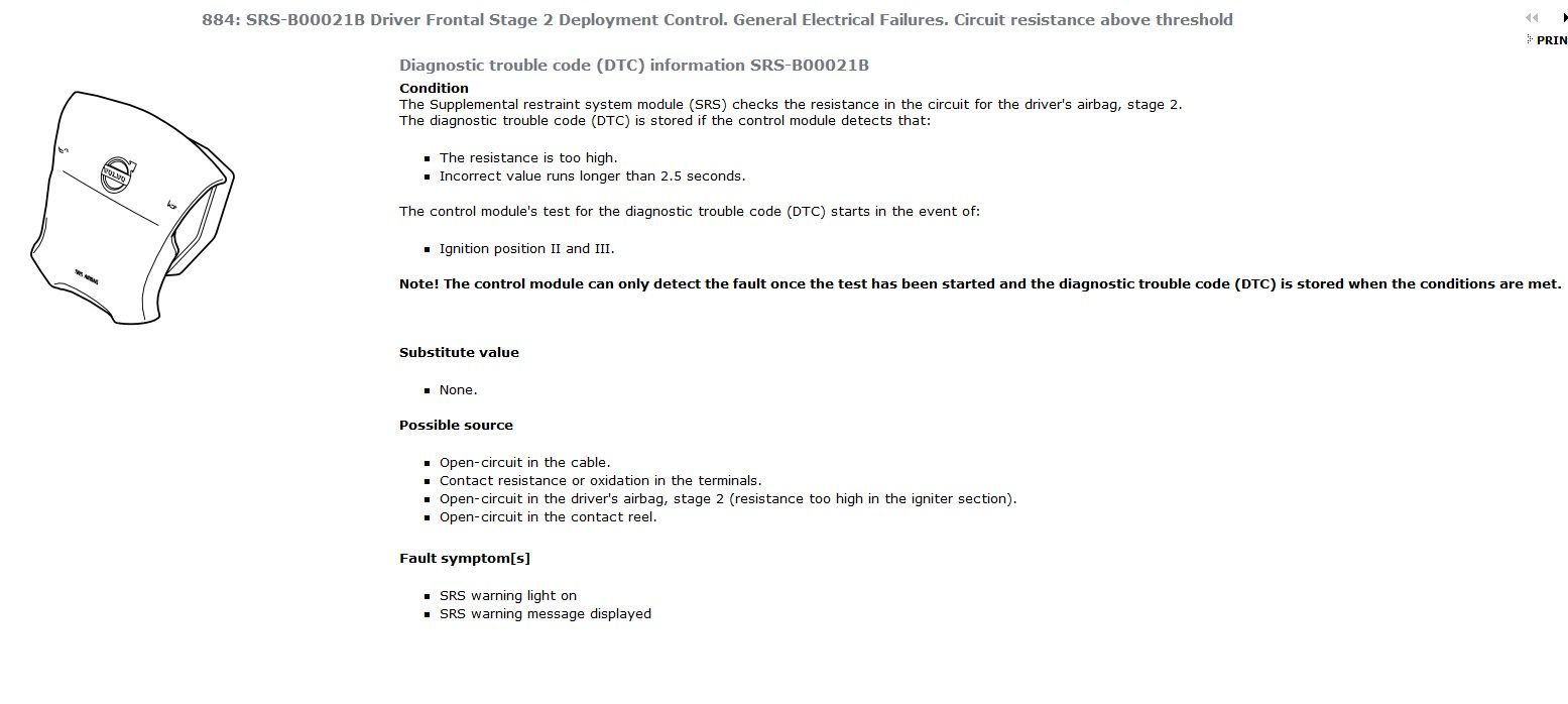

Driver's side, and the code is:
B0002-1B Driver Frontal Stage 2 Deployment Control General Electical Failure
Old Dec 20, 2025 | 01:48 PM
Volvo says code b00021b - is a trouble code related to the DRIVERS AIR BAG in the steering wheel. Many possible causes, but replacing the drivers seatbelt will not fix it. Are you sure about you choice of Technician?
Possible source - connections or problem with contact reel. Have seen/replaced many bad contact reels. Easy to test. Contact reel part number is 31313818 or 31343218 depending on your VIN.
