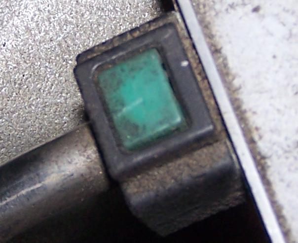

I was mistaken that the fuel pressure sensor was attached to the line. A volvo service manager told me this.
I am still in a fix on how to disconnect the fuel line. It is a very different connection than what I am use to.
It is black rectangular box with two green smaller rectangular (think buttons) on top and bottom.
Called volvo they were clueless on a tool to use.

Can you post a pic?

Default here is a picture tech
[IMG]file:///C:/DOCUME%7E1/aaa/LOCALS%7E1/Temp/moz-screenshot-1.png[/IMG][IMG]file:///C:/DOCUME%7E1/aaa/LOCALS%7E1/Temp/moz-screenshot-2.png[/IMG]removing fuel rail cover 2003-car2.jpg

Ok you have to press the green buttons in then pull the line off.
