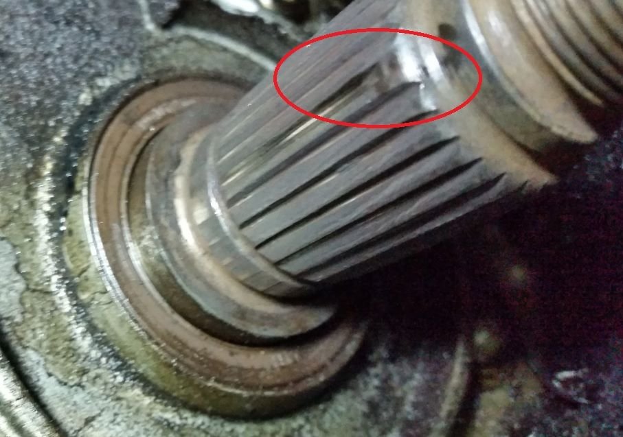

Old Apr 27, 2022 | 10:43 AM
"how will I be able to aligned the crank gear with the crankshaft?"
A new crank gear only fits one way on the crankshaft - there is a spot weld between two splines on the crank - The crank is harder steel than the gear - so usually just replace the gear (and the valves if bent)
https://volvoforums.com/forum/volvo-...ng-gear-89394/
