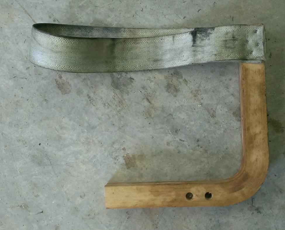

Default my filter strap wrench
this is a bent piece of wood that i stumbled on and some strapping that i saw on the side of the road...it works
