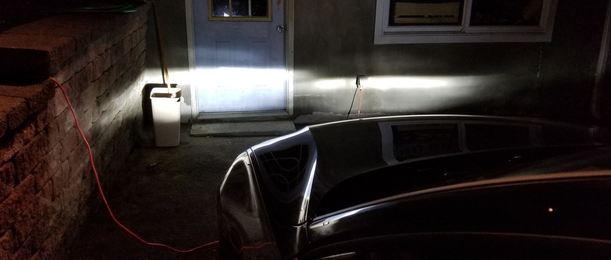

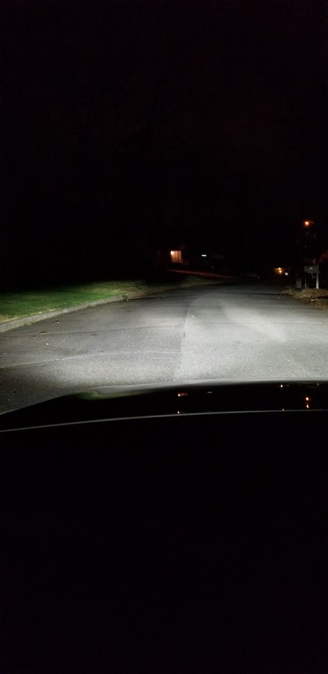

Hello everyone,
I am new to this forum. I just recently leased an s60 t5 2021 and am having headlight issues, where they face slightly low so they dont reach far enough. Some spots in the headlight ray has black spots missing light and one headlight is pointed slightly higher or lower than the other. I have heard mixed things and they have already changed the lights once. I have my next appoint in 5 days. Not sure how to convince them that they need to adjust them. They claim it is supposed to be that way, but i dont know. Has anyone experienced this? What should I do? I have uploaded some images!

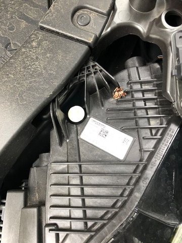

Adjust the headlamps, takes a 6mm socket, darkness and about 8 minutes - the right one is lower than the left and they may both be too low. Looks like this - or may be covered by the core support on a s60 - but it's there
