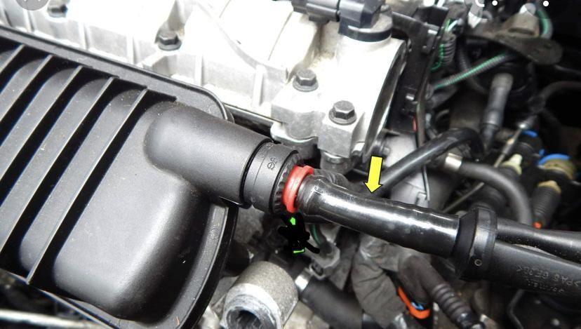

Hello All,
Working on my 2012 S60 T5. Getting the P2187 code and a CEL. Was quickly able to track down an obvious and audible vacuum leak from the brake booster line coming off the inlet pipe. The leak is originating at the connection between the booster line and the inlet where you can see the red, circular release in the attached image. Ignore the arrow as the issue is with the red part.
I have not been able to locate this connector in any diagrams and went to Volvo directly for help. They told me the part is only available on the entire plenum to the tune of nearly $600. I refuse to accept a cents work of plastic that snapped into the plenum to create a seal isn't replaceable. Could anyone advise on this?
