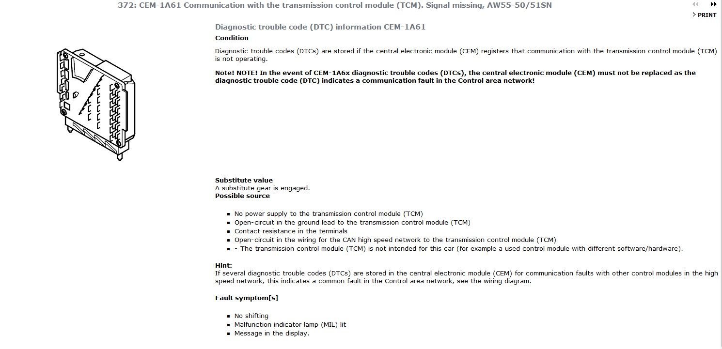

Your 1a61 is non communication the the cem. Here's what Volvo suggests might be the problem. Unfortunately for diagnostics the only thing Volvo suggests after checking for electrical corrosion at connectors in the system is connecting their breakout box. And making sure there is not a problem in the low and high speed network wires. That's going to require someone familiar with CAN networks, is very adept with electronics and a bunch of reference material. (A wiring diagram and appropriate test equipment. )

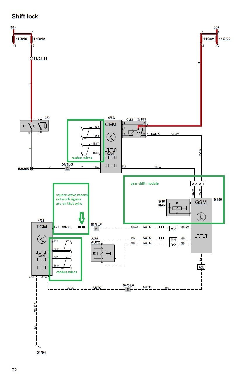

That was me dreaded fear unfortunately, the shifter stopped illuminating also ,does the can bus run through the shift selecter ?
Old Nov 28, 2022 | 05:04 PM
Yes the shifter is on a network
