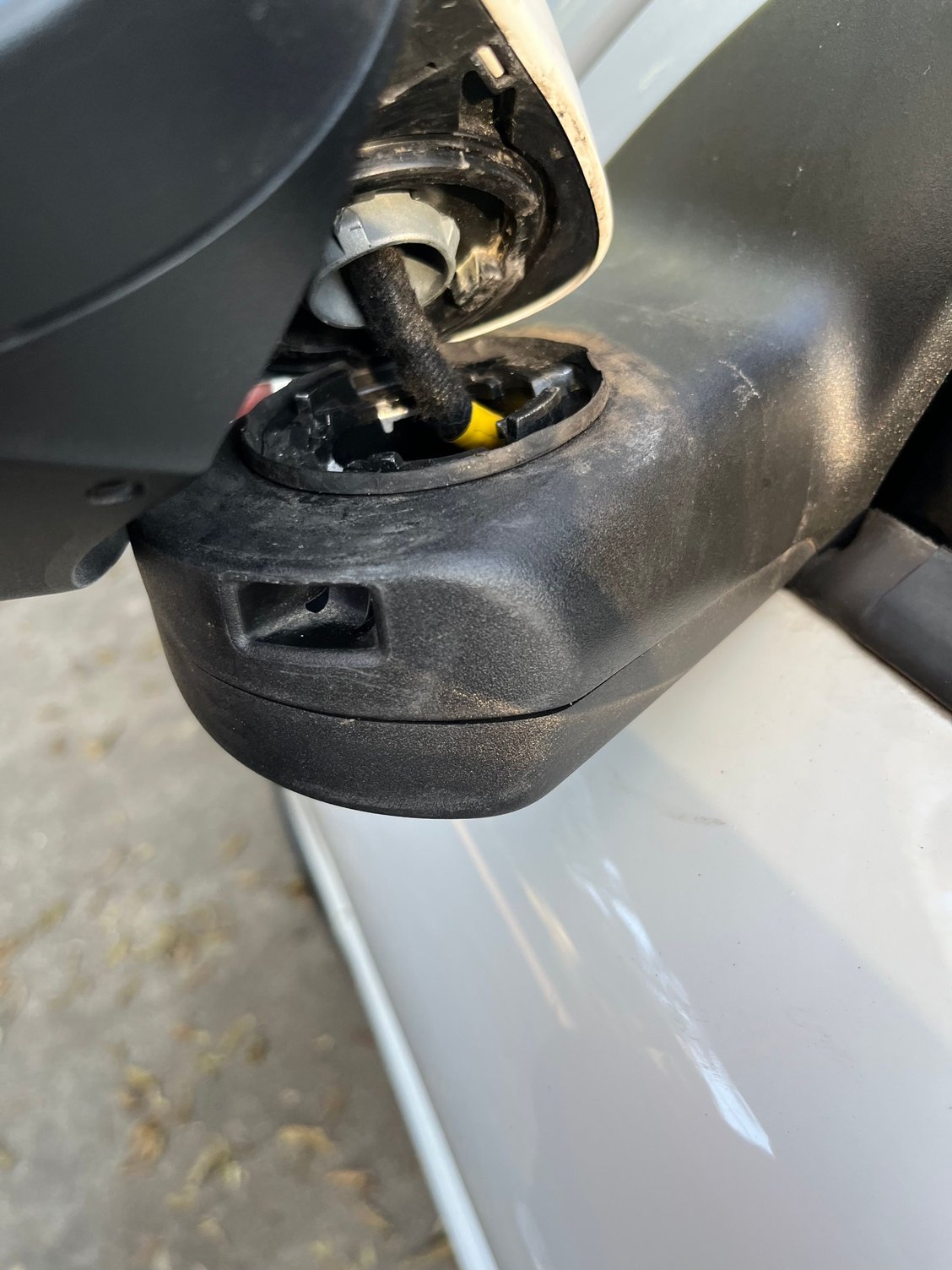

I have a 2007 Volvo S60 2.5T. Recently my side mirror broke off, i’m decently sure someone snapped it off but regardless my mirror is hanging by the wires. I don’t want to replace the whole assembly but i can’t find the part i’m looking for. The mirror sits on the ledge and there’s a connector piece that looks like it’s been damaged. If anyone can help identify the part i would greatly appreciate it. I will attach a picture of the affected area.

The mirror base is broken. Item #1. Cover, lens, glass, and other parts are reused and sold separately. There are many variants - w/blis, elec folding, with or without illumination and memory - The best way to figure out what part number you need - is to call your local dealer, give them your VIN and have them figure out what the correct part number (and their price ) is - then choose your vendor. (if you put the wrong type used mirror on, the electric adjustment won't work) It is a dealer only part - but you might find it at a slight discount (from Volvo list or list + that dealers usually charge) from an aftermarket source (fcp, ipd, eeuroparts, etc.)
Or in Atlanta Voluparts.com sells factory volvo parts (sourced from the local dealer) below Volvo list price. 404-352-3402 They have used parts also -
