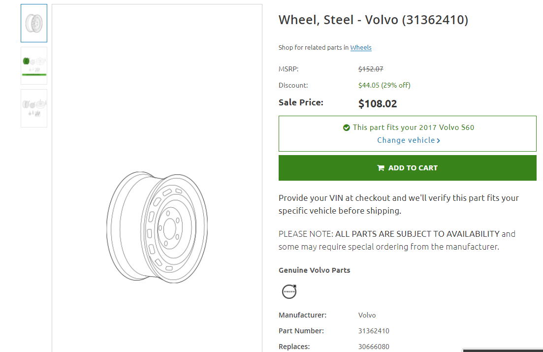

I have a 2017 S60 T5 Dynamic with 18" wheels. I had a flat and realized there is no spare. So I went on line and ordered what was described as a black steel rim for S60 with 18" rims.
When we took it to have a tire mounted on it, we descovered that I was sent a 17" rim. The question is now what size tire should be put on it and is it ok to run a 17" wheel with the rest being 18".
I contacted the place I bought the rim from and they are of no help. The rim came in a Volvo box and is a Volvo part. Did they goof? or is the spare wheel supposed to be 17"?

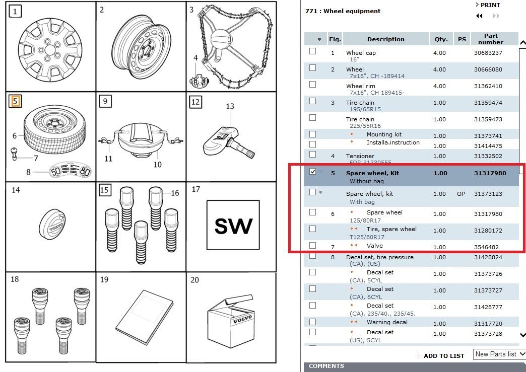

Did you order a full size spare? or a donut? What part number did you order?
https://tiresize.com/calculator/ you can use this link to compare tire sizes to get something that matches if you have to run the 17"
Old May 4, 2022 | 12:03 PM

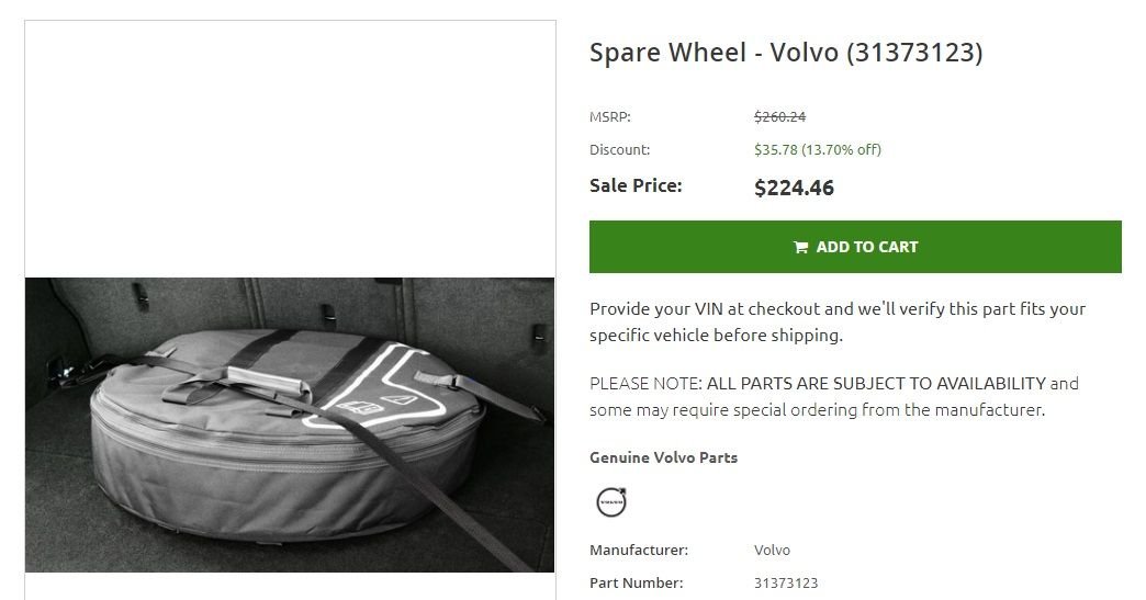

Here's the parts catalog page with the tire size - and volvo sells a complete spare in a bag with tie downs.

Full size steel rim? Didn't know steel rims were an option on the newer volvos. Interesting
Old May 4, 2022 | 12:40 PM
ZZtech's Avatar
Joined: May 2022
I purchased the wheel pictured in the above post. Labeled as #2
