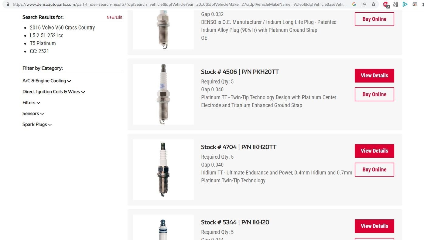

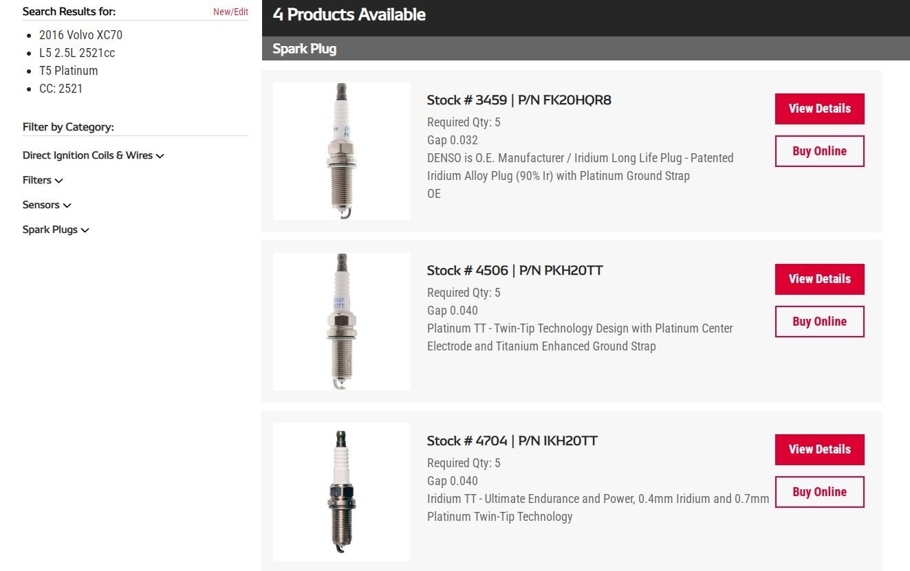

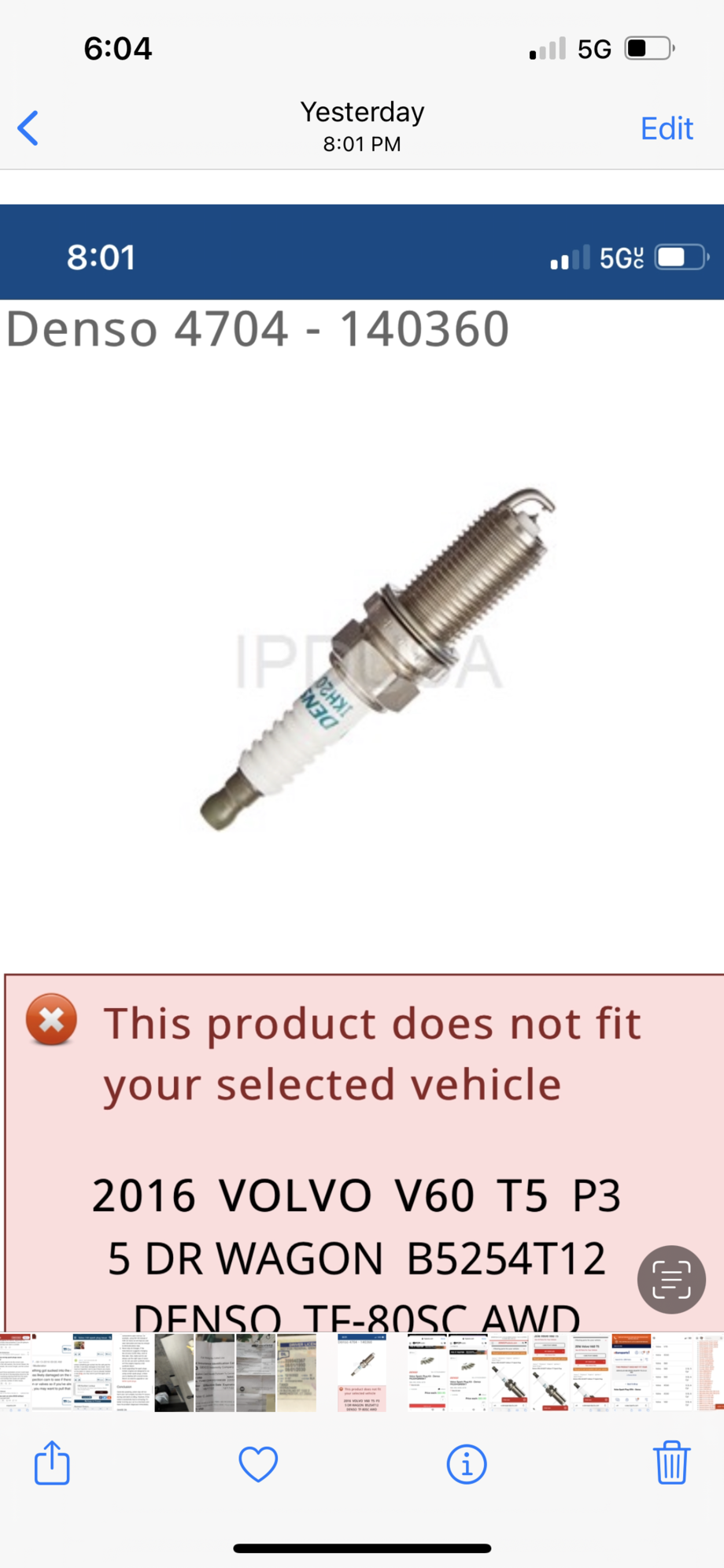

hi i have a quick question regarding spark plugs. i have a 2016 volvo t5 cross country wagon. 2.5 turbo, i brought in to firestone and thdf changed the plugs. they used 4704 denso iridium tt plugs. one is bent and i’ve been told these mighty not be correct plugs. i am told they need oe metal iridium. when checking this out i’m coming up with different plugs. i’m also getting websites thsf say the 4704 no not fit thst model. any suggestions? please help in desperate need of answers

Looking at Densos' online catalog - the 4704 is listed as a compatible plug.

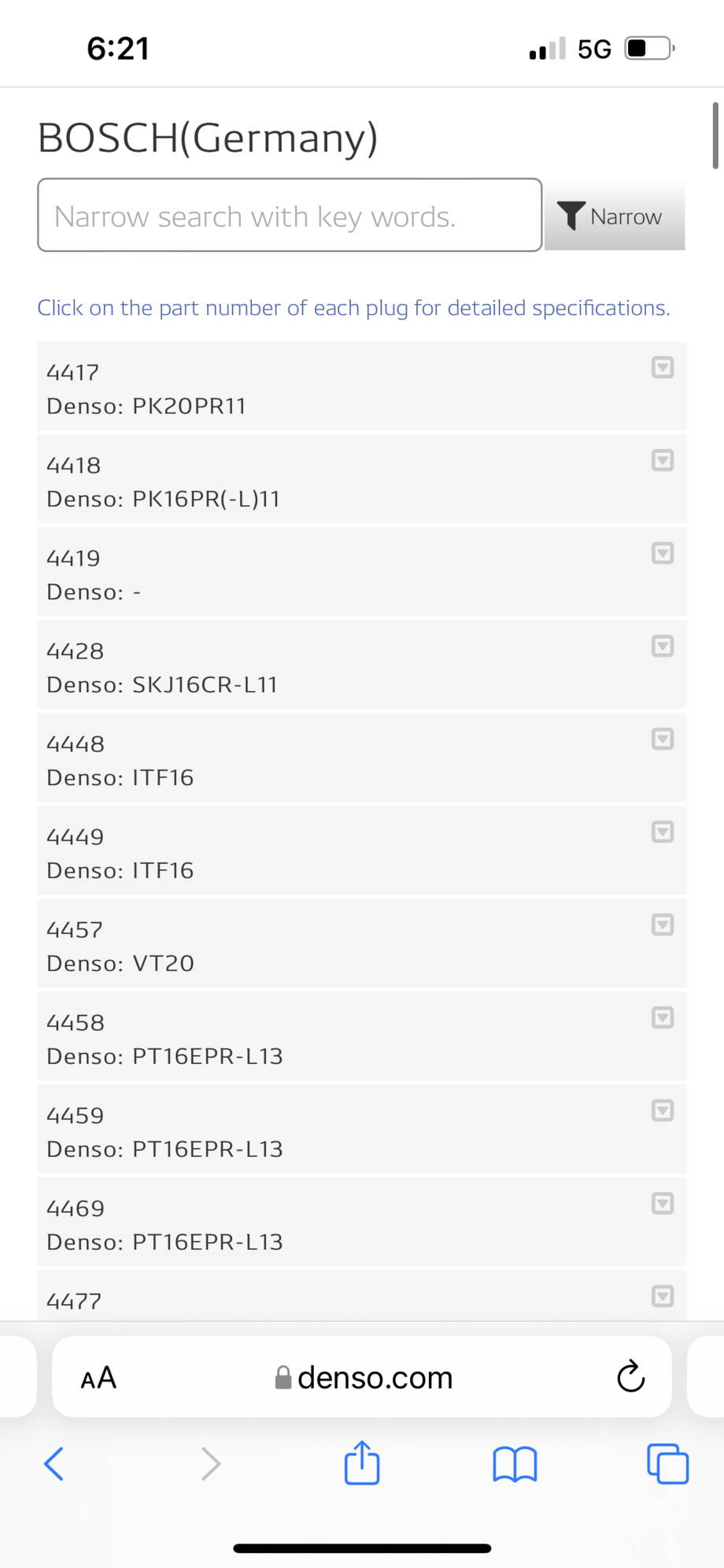

also
the manufacturer is bosh. 4704 are not on there

I simply went to the denso website - address is at the top. Personally - my shop ALWAYS purchased (and installed) spark plugs only from Volvo. With my discount they were about the same price as denso or bosch plugs from my wholesale supplier.
