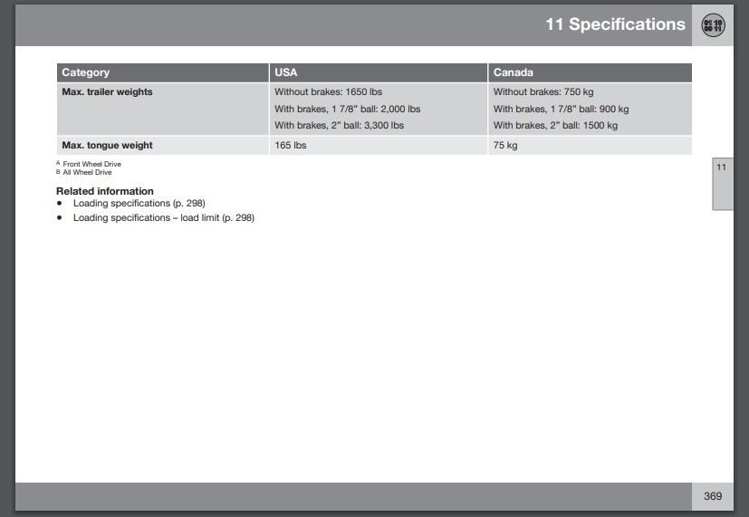

What size boat are you considering? Total package would weigh? And how far would you tow it? IO or outboard, Fish, ski, surf? I've always been reluctant to suggest/encourage my customers to use their Volvo to tow a boat. Have had to replace too many transmissions.

Cruising boat like the Bayliner e18 outboard which, with trailer, weighs 2,473 LBS. No more than 25 miles on flat land.

With gear and fuel you might could get near 2800 pounds for that setup. Volvo suggests that car can tow 3300 pounds - when brakes are installed on the trailer. I also wonder how easily that FWD car would pull a 3000 pound boat out of the water. Years ago I had a friend that would tow his 18ft outboard with his Peugeot 604, a 3000 pound car with no brakes on his trailer.

ok thanks - doesn't sound like a good idea.
