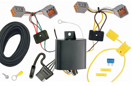

I've got the Tekonsha "plug-in-play" trailer light kit.
Tekonsha connecter kit
Is this a fairly easy connection to the wiring on the 2016 S60 wiring? Any videos that show the connecters of the S60?

they had a similar install video for another car is all. I think i get the gist (install in line between the existing tail light connection) of it but how do i thread a wire from the trunk all the way up to the battery on the S60?

You find a high amp B+ source in the trunk. A test light is your friend in this case. Maybe even a big red wire -

"high amp B+ " is what? The kit i bought wants to run a wire (included) from the box in the trunk to the battery up front so as to not overload the existing wiring. Is there a clear path for the wire to do this?

B+ usually refers to a Positive unswitched 12v source. (battery positive voltage = B+) And you would want a higher amp capability - a larger diameter 12v wire, preferably not fused (unless with one of the larger fuses). The REM (rear electronic module) in the trunk might be an easy way to power the trailer light adapter.
