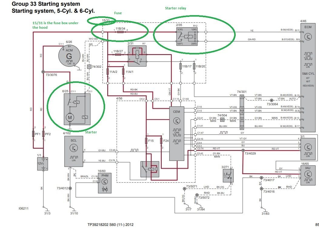

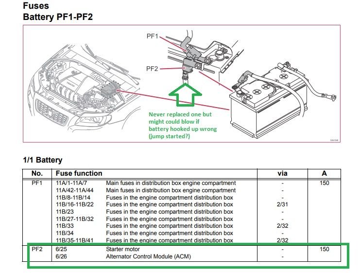

Here's a wiring diagram and location pages. Big 150A fuse (PF2) on the positive cable - have only seen a physically broken one, never a blown one. It's part of the cable (You mentioned your battery being used to jump start something, could have been damaged then?) That 150 amp fuse only goes to the starter and the alternator - meaning everything else in the car will work. The large red cable on both the starter and alternator are not easy to get to - but that's where you need to find 12v if you think PF2 is blown.
Check for 12v at relay terminal 30 will test fuse 34.

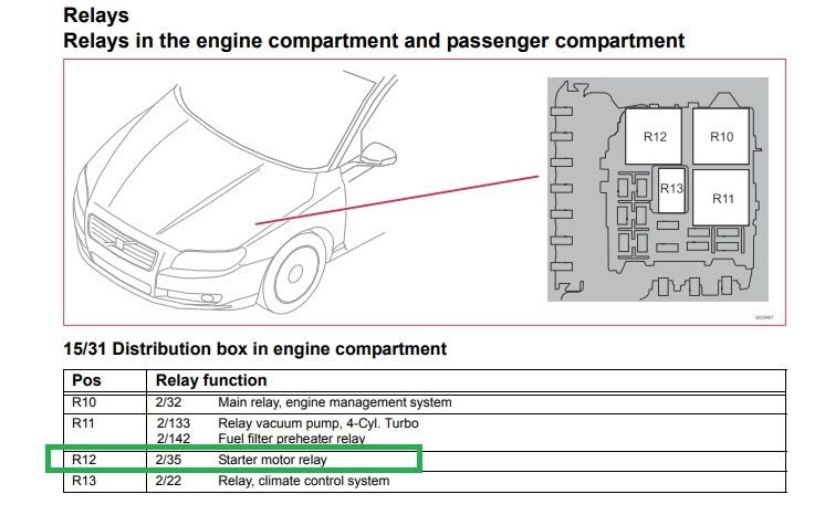

Starter relay r12 - with it removed use a jumper wire to send power to the starter to test the starter. If there is an identical part number relay in the fusebox, swap it the the starter relay to test the relay.

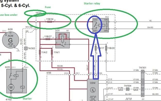

If you make up a jumper wire with 2 male terminals,
unplug the starter relay and jump between terminals 30 (where you will find 12v with your $5 test light if fuse 34 is good) and terminal 87 (that sends power directly to the starter solenoid), circled in blue. The solenoid will click and the starter will engage. If you just hear the solenoid click - there is may be no power on the fat red wire getting to the starter. (maybe due to a bad 150A fuse built into one of the positive cables at the battery) If you still hear nothing and you are certain you have 12v on the fat red wire on the starter and 12v on the small solenoid wire when you have jumped the relay - and you are certain the battery is fully charged and passes a load test - You MIGHT have a bad starter. I would still make 100% sure the starter was bad BEFORE ordering a replacement. I would attach jumper cables to a known good battery and a remote starter switch directly to the starter and try to energize the starter with those. Then if the starter still did not work I would bench test the starter after I got it out of the car, using jumper cables and a remote starter switch. Only then would I pronounce the starter bad, for it's pretty rare for them to fail.

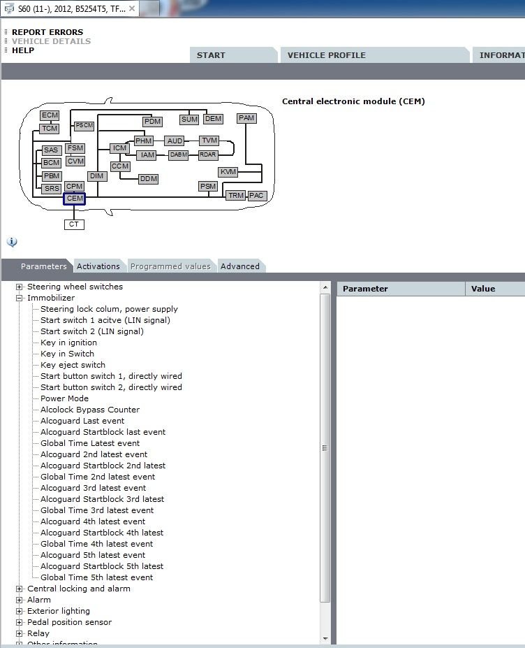

The next thing (actually would have been one of the first things) I would do is connect an appropriate scan tool. Scan the car, record what's there and erase all codes. See if it starts. With that tool you can see what signals are going where. Attached is a screen shot from VIDA, Volvos scanning software. Click on any of those items and you can verify key in, start switch activated, all sorts of parameters. If the starter spins the engine over when relay is jumped maybe if the ignition is on when you bypass the starter relay the engine will run, avoiding a tow bill to the hopefully Volvo specialty shop that has appropriate diagnostic capability. The next step is to figure out why the the ECM or the CEM is not sending a start signal - and that can't be done with a test light and a jumper wire

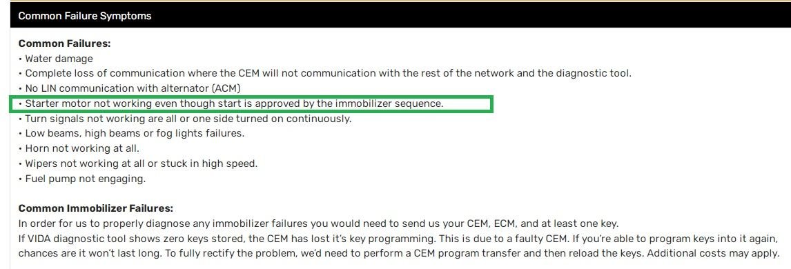

That is certainly possible and I mentioned that earlier - but you don't need VIDA to do that. There are many capable scan tools out there. The CEM is coded to the VIN also - a used one won't work unless you use a company such as xemodex.com to transfer your CEM program to a used unit. I have replaced many CEM's in Volvos due to water intrusion, and that water damage causes all sorts of malfunctions - but again is just a guess until a scan has been done on the car, a visual inspection of the CEM itself, and elimination of all other possibilities.
Having owned a shop for 40 years, and been in the business for almost 50 - Customers are not "taken advantage of" at least intentionally. What happens is customers end up paying for the inept "mechanics" who at times have no clue how to diagnose or fix your car. That's why sometimes it's best to use someone either with more training, or if they are going to learn on your car - at least have the ethics to not change for their education time.
These are common fault symptoms from another type of Volvo CEM courtesy of xemodex
