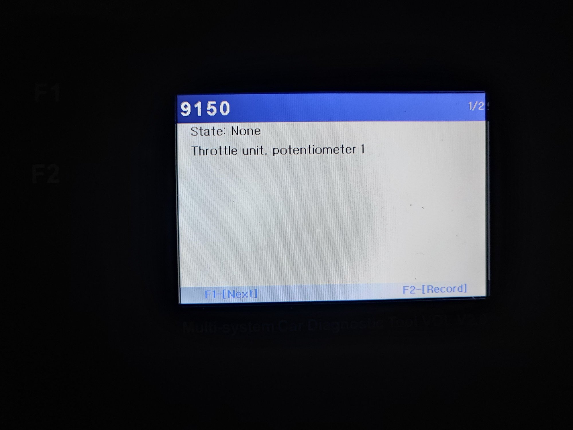

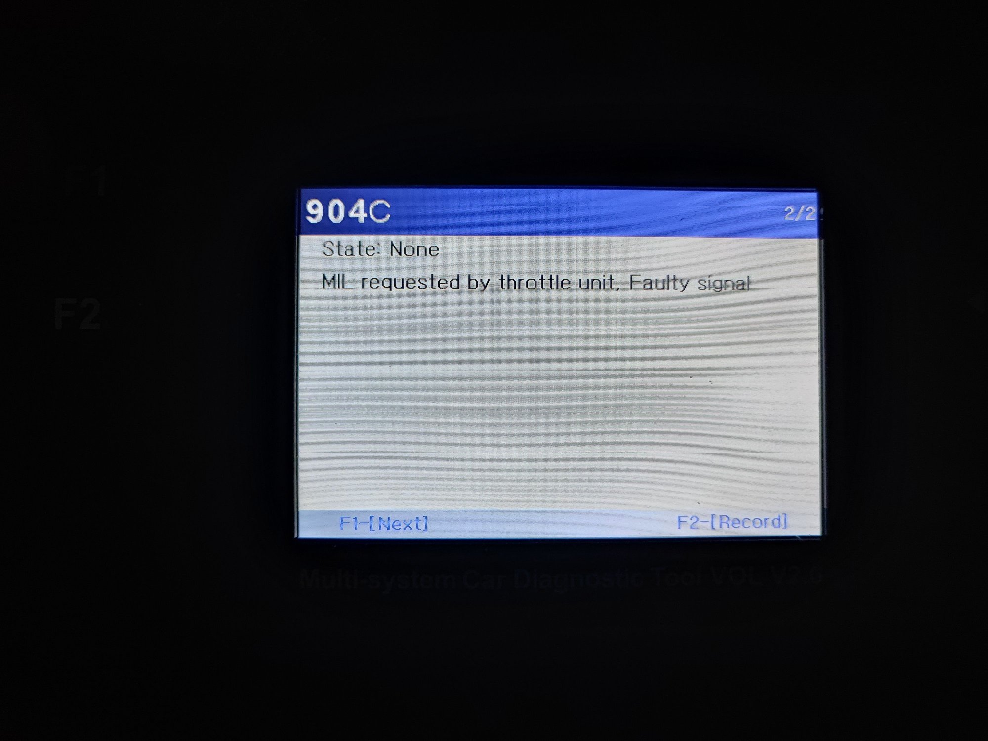

So today finally an error related to the TPS shows up on my iCarsoft reader.
could this be the confirmation that my TPS needs to be replaced?
Any how I ordered a vida and should arrive this week.

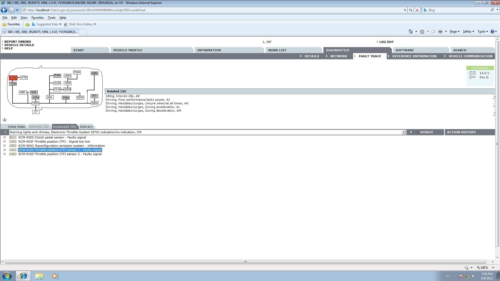

And today i checked for errors with the icarsoft and now the error potentiometer number 2 from the throttle module was present and clutch pedal position sensor error.
Is it possible that im assuming a TPS problem but something else could be causing all this?
Thank you.

Since it's an electric throttle body. The cruise control going out because of a TPS fault would make sense. The car wouldn't be able to accurately control/correct speed if it isn't able to monitor throttle position properly. Does your nominal throttle position line up with your actual throttle position values?
With VIDA you can also check / test communication with the units. There's a lot inside VIDA and I wish I could help you navigate the pages step by step but I have not used it on my personal cars nearly enough to keep that knowledge in my head.
Did you check XeMoDeX website about the throttle bodies like mt6127 suggested? They are a great company if you do need to use them for repair.

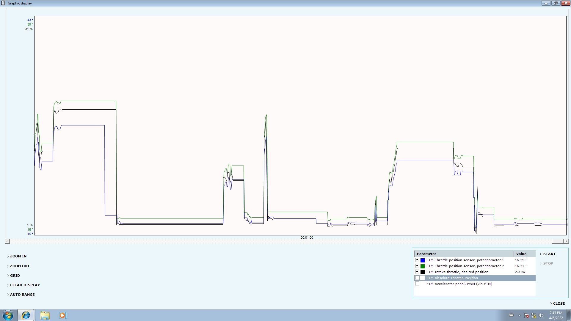

So today i uninstalled Vida 2015D and installed 2014D instead and I am now able to comunicate with ECM and can read several errors. But now when i'm connected to the car i have a constant relay switching on and off with even timing. I have no idea if that normal but maybe someone can give some input about that.
I also tried getting a sample of the desired throttle position and both sensors position. I did notice that the sampling graphs were substantially slower than when i used Vida 2015D and seemed to cut communications periodically. (Maybe it's related to the clicking relay?)
The desired position is substantially lower than the one measured by the sensors.
Thank you.

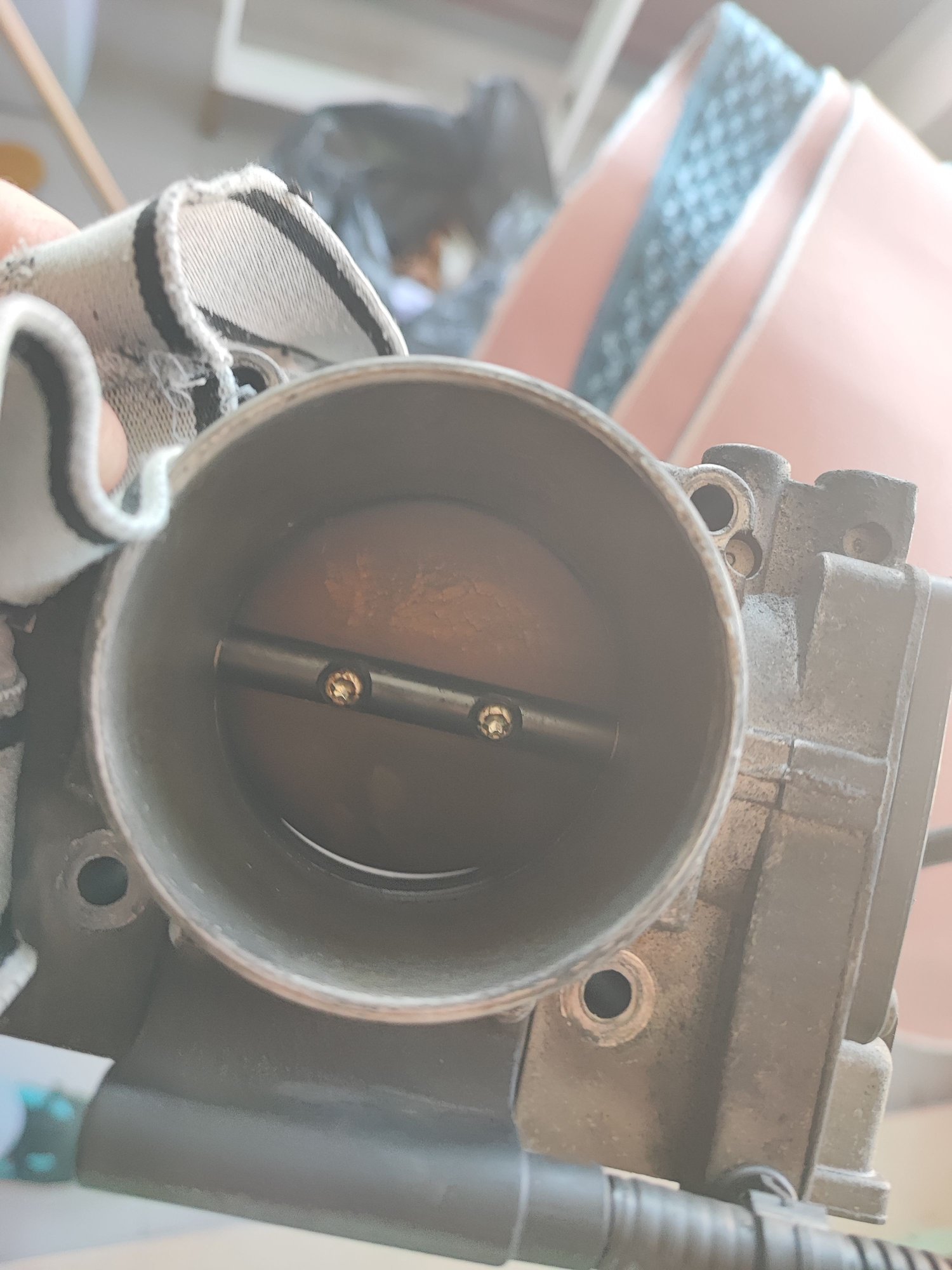

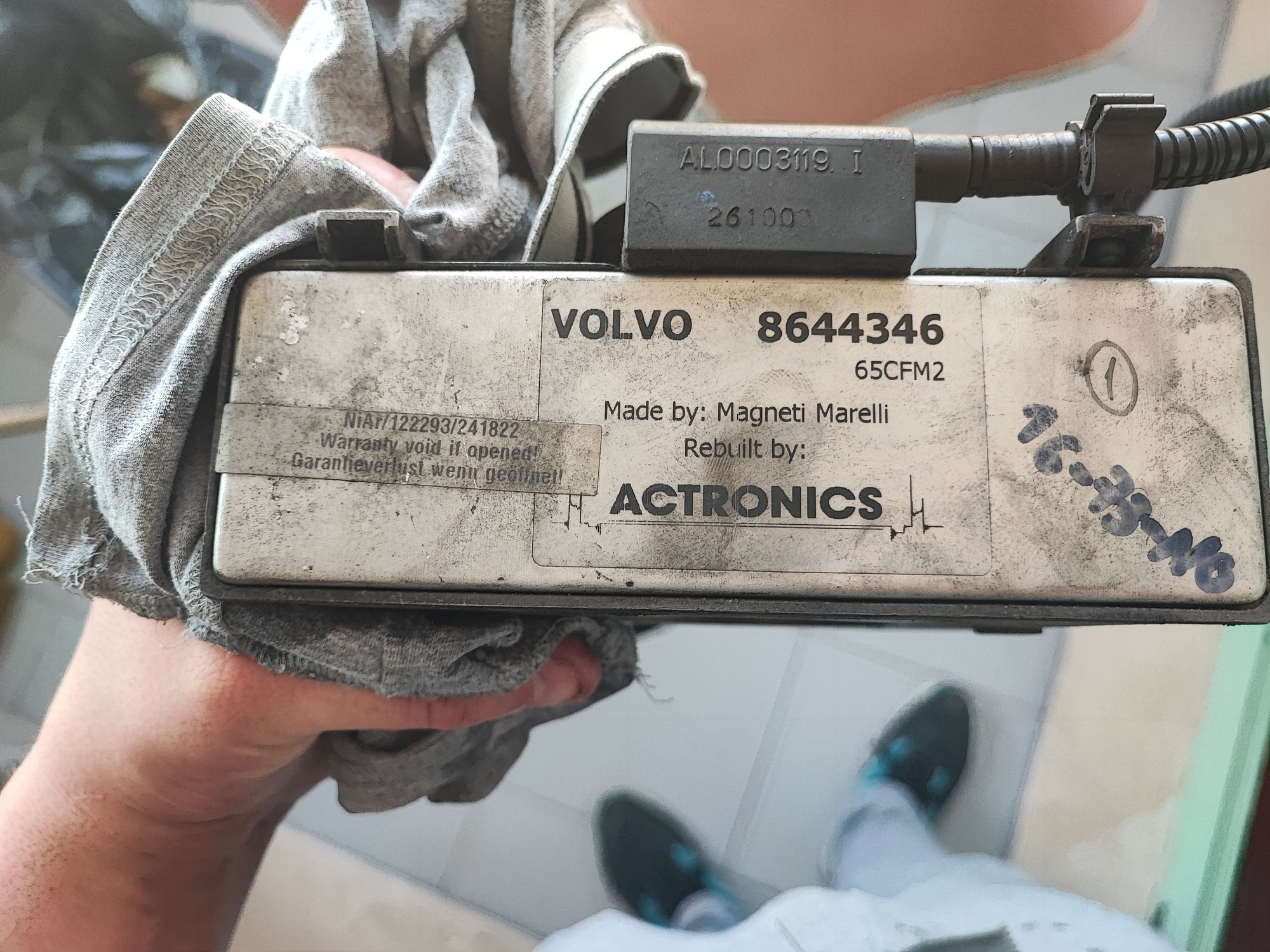

I'm completely lost.
So I just removed the throttle body, and to my surprise, the previous owner had already had the TPS moded.
By the looks of it, by actronics.
Any ideas?

Very late reply, but did you figure it out eventually? Lots of people have bad experience with ACTronics rebuilds, I wouldn't be surprised if it failed after a few years.
Old Dec 3, 2022 | 10:26 AM
HeXx's Avatar
Joined: Feb 2022
Posts: 11
Yes I did. Replaced the sacer sensor but kept the magnet part and it worked like a charm.
