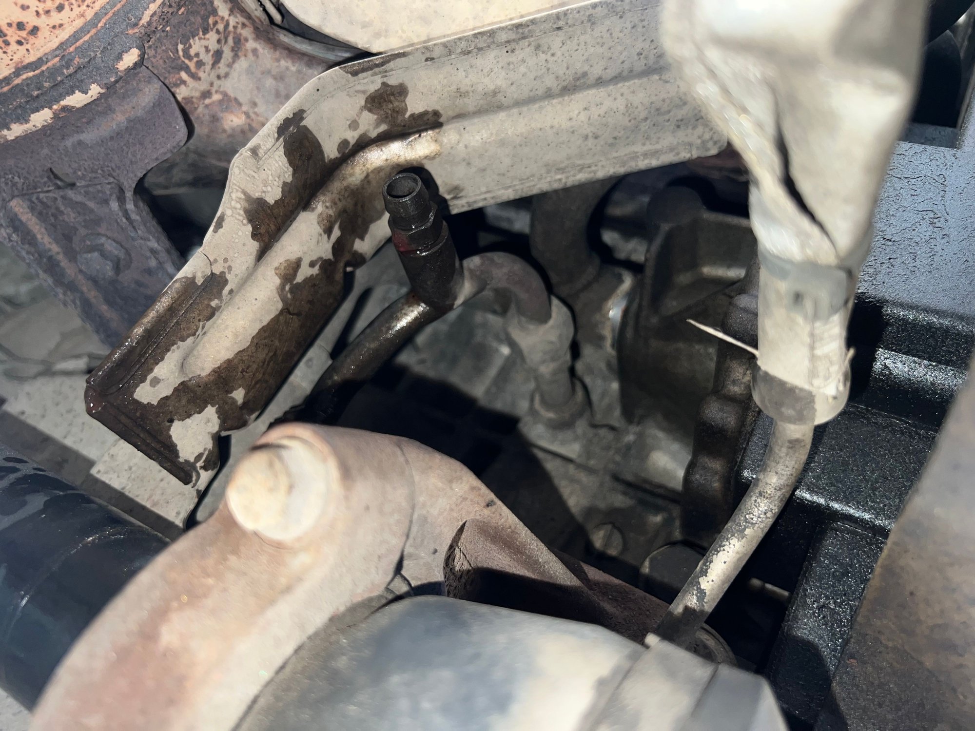

My volvo s60 is leaking coolant from this coolant connector? Powersteering fluid is also leaking.
Is it missing hose or something? Those pipes go to oil cooler

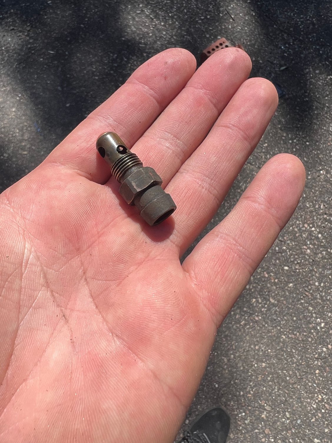

What you are holding in your hand is a drain nipple. My '02 has one at the rear of the engine for draining the block during a flush. Make sure it is clean and tight. Just above the RH drive axle.
