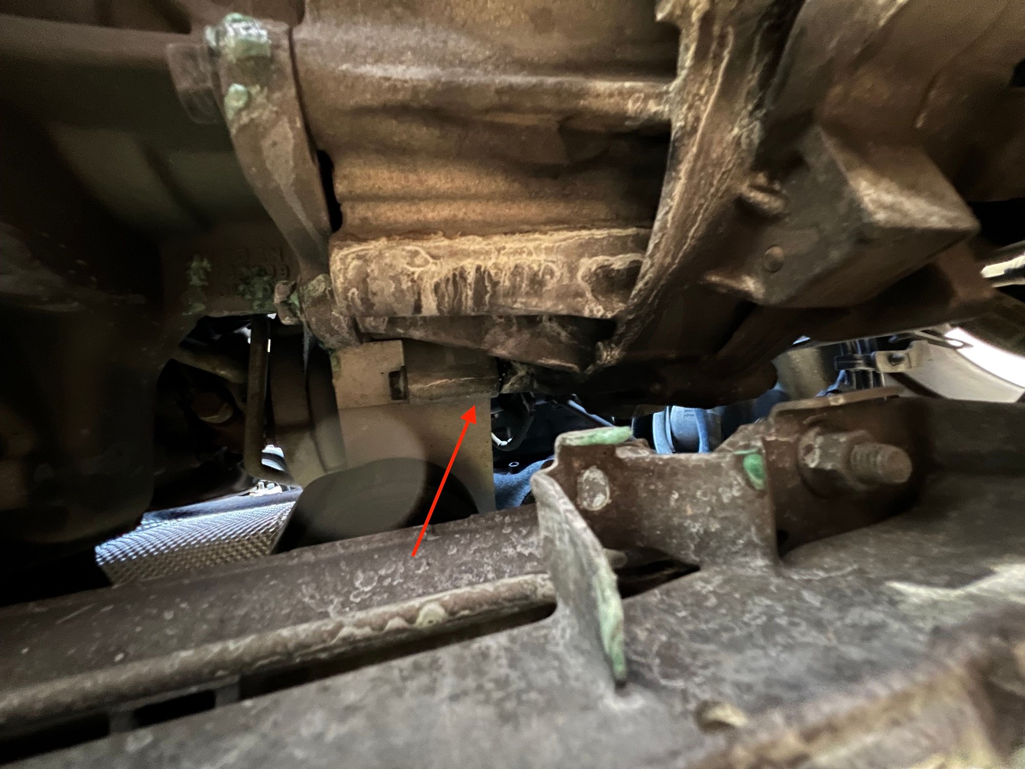

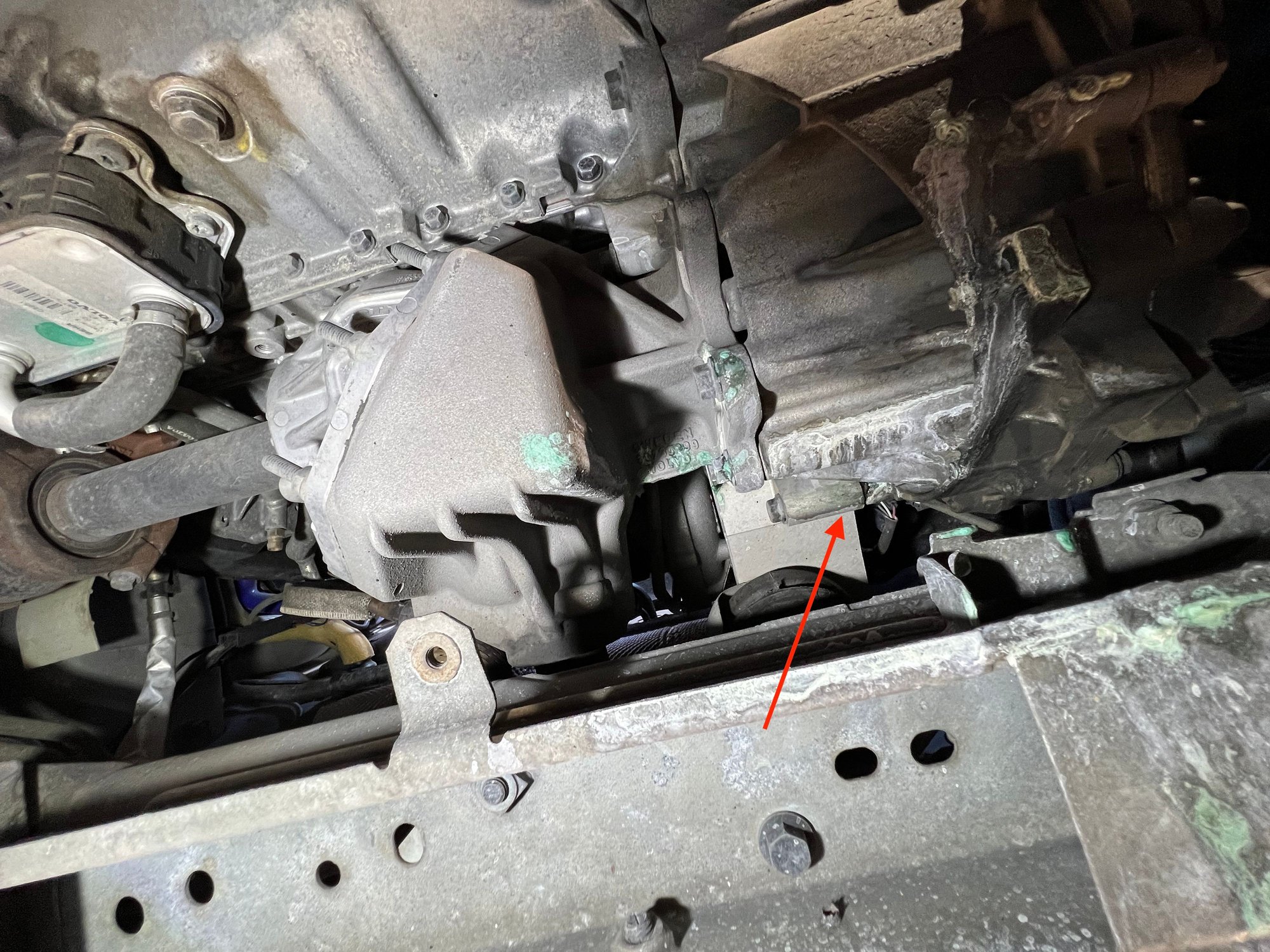

Unhappy Coolant looks like it is leaking from clutch housing???
I been having to top up my reservoir lately. Leaking on drivers side. Last week I parked it on some ramps thinking it was probably a radiator hose and finally got around today to taking off some parts to have a look at all the hoses and clamps and they all looked perfect. So I started it and let it hit operating temperature and no leaks. Crawled under it and still no leaks, but dry crusty glycol remnants. Shut the car off for 30 minutes and when I came back I had a small puddle, so crawled back under it and the only wet spot is the one boss on the transmission to final drive. The manual transmission nor final drive should have coolant in them. Any thoughts?

It has to be the heater hoses, right? The hoses are not leaking at the fire wall, but maybe the other ends, which I can not see, but I know they are over this area. Any recommendations on how to replace the heater hoses?

Do a search on replacing the heater core and there are a couple threads that include replacing the hoses. The common place for leaks is the clips that hold the heater hoses to the heater core. They have to be fully seated or you will tend to get drips/leaks. Before I went that route I would look hard from the top of the engine down in the vicinity of where it puddles to see if you can get a better feel for where it is leaking. If you do change the heater hoses, I would go ahead and change the heater core as well as the hose clips, since you would already be halfway there, and if the heater core is original it is only a matter of time before it will need to be changed. Not a hard job, just put some garbage bags down on the front carpets to catch any coolant when the core is removed.
