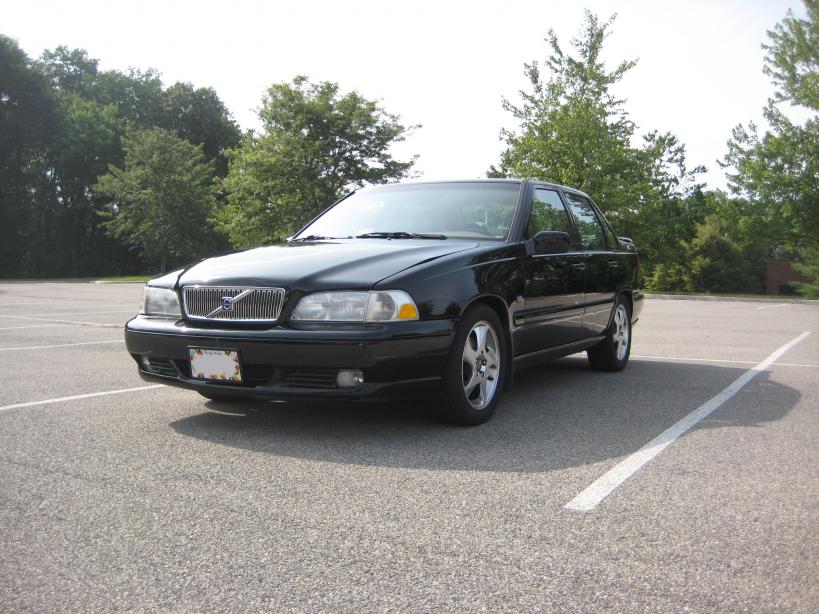

Thanks for the answers. I guess I need to find a good Volvo mechanic for timing belt. And you are right. I got this car used recently and cheap. It has some previous collision damage though I do not think it is severe. Hood is slightly buckled up and there are signs of collision at all bumper corners. I hear some noise like from an old wooden pirate ship when I turn from end to end while pulling it out parking lot. But that does not bother me much. Here is a pic of mine after waxing.

Pretty sharp!!
But before you soak a ton of $$ into it though, i would take it in for a full 4 wheel alignment. They will be able to tell you if the frame (or anything else) is bent. It would be a shame to put a few grand into it and then find out it can't be aligned! My $0.02 anyway...
BTW: have you changed out a timnig belt yourself on any other car? These cars aren't too bad to do a timing belt R+R on; just need to know what you're doing and be careful. Lots of good write-ups out there on the procedure.
Good luck!
