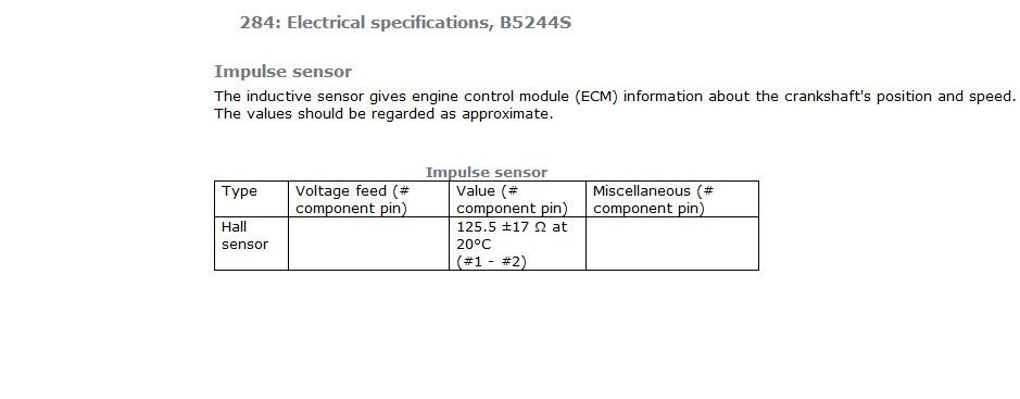

Here's the spec on the speed sensor - bad ones the resistance is way off - or the insulation is damaged. Sometimes they get damaged from a foreign object loose in the bell housing (rarely)

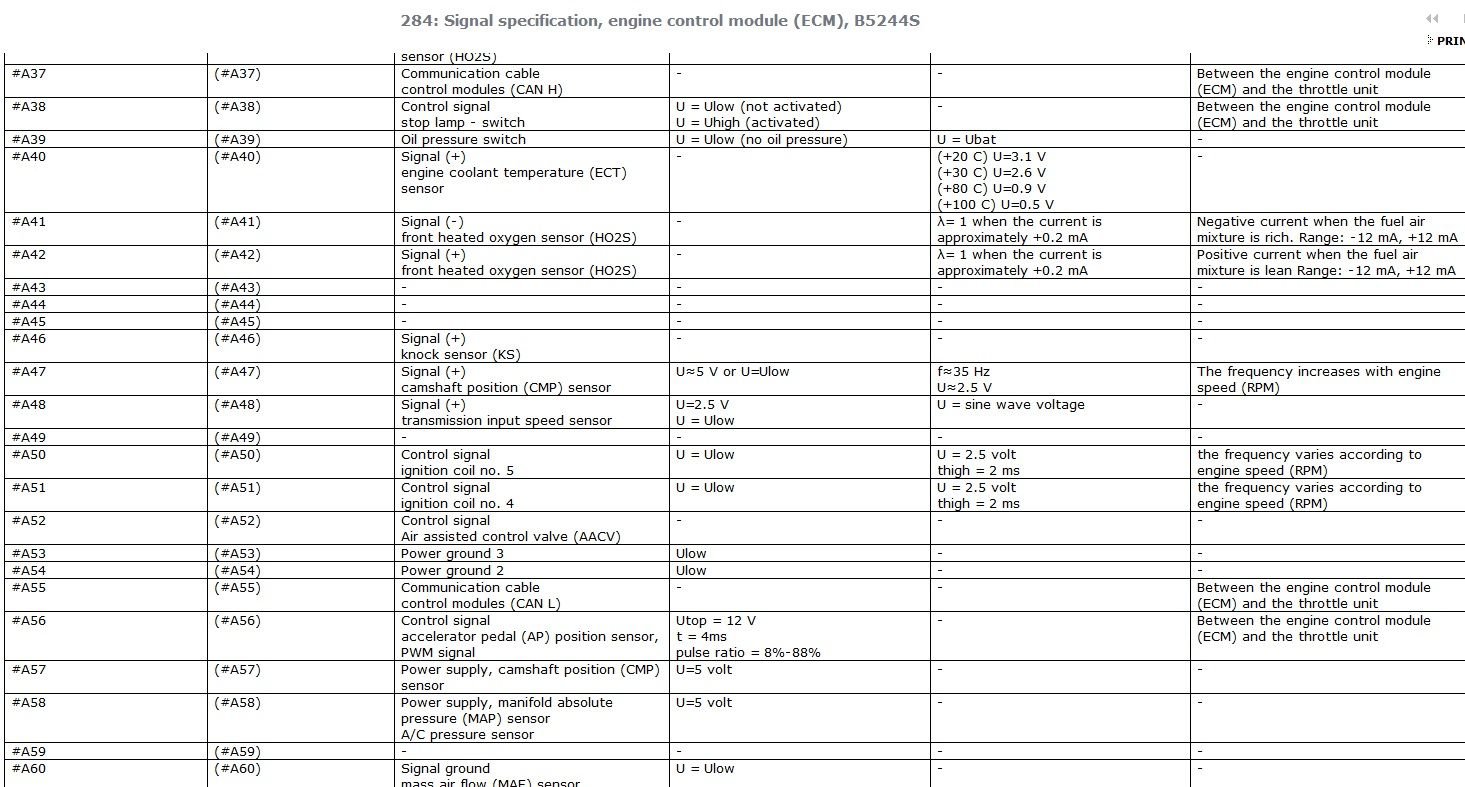

Have no clue - 2.5 or 5 volts probably. But I do know if the resistance is ok with the sensor you are looking in the wrong place and should guess somewhere else. What codes are stored? That should be your first step. On the chart there's a description of every one of the 120 wires going to the ECU - very rarely does anyone refer to this stuff - What codes are stored?
