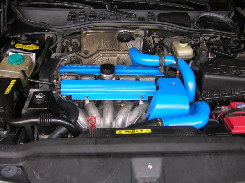

This is a turbo engine. Fresh air from the front, to the air box, from the air box to the turbo behind the motor, and then back up to the intercooler, then to the throttle body. If yours does not do that, then you have an n/a, aka no turbo.

cool blue. Thanks, I will look. what is the blue cover next to the two hose going down? Your air filter says TURBO. Not mine. But let me double check the set up. THANKS very helpful!

That's the throttle body cover. They stopped putting turbo on those boxes a while ago. The x70's don't have the "TURBO' on the air box.
