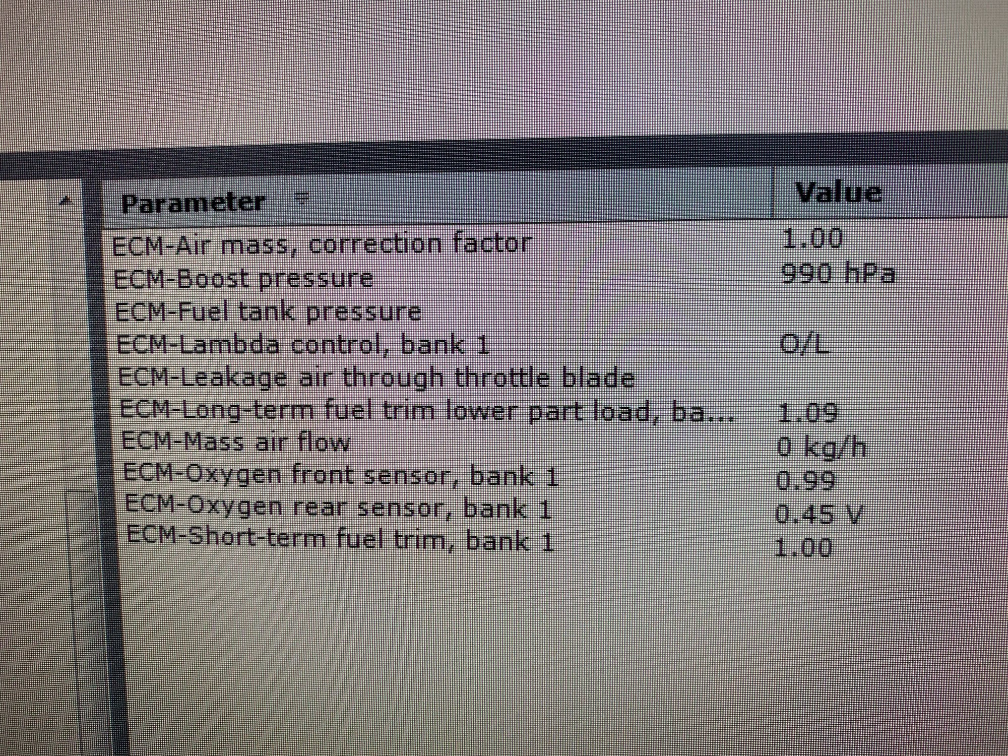

First attachment is a picture of the life data on oxygen sensors, with ignition on (engine off).
ECM-Oxygen front sensor is reading 0.99 V
ECM-Oxygen rear sensor is reading 0.45 V

5. First attachment is a picture of the life data on oxygen sensors, with ignition on (engine off).

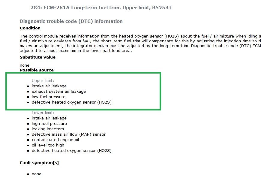

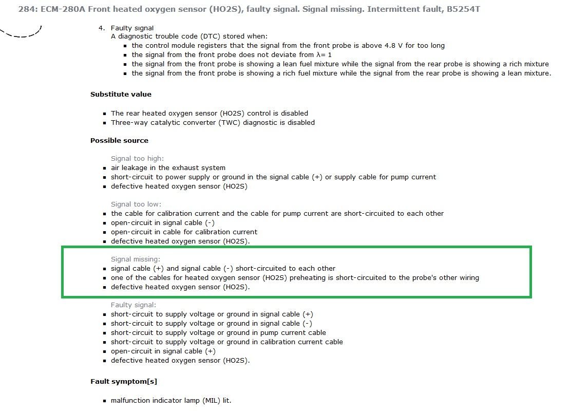

1/2 - You have Vida. If you click on the code you get the screens below - have you tried Volvos suggestions as to a possible source? (highlighted in the green boxes)

5. Measuring O2 sensor voltage with engine off is not a valid test for anything. O2 sensors don't output valid readings until they are ~700 degrees - and the ECU ignores the signals for X time after the car is started to allow them to heat up.
