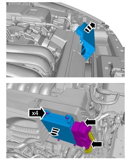

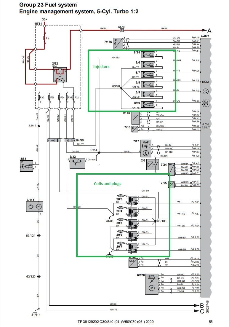

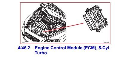

Ignition is controlled by the engine control module. Controls fuel injection and ignition. That module is located on the air filter assembly.
