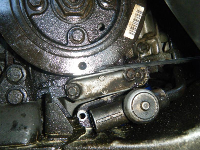

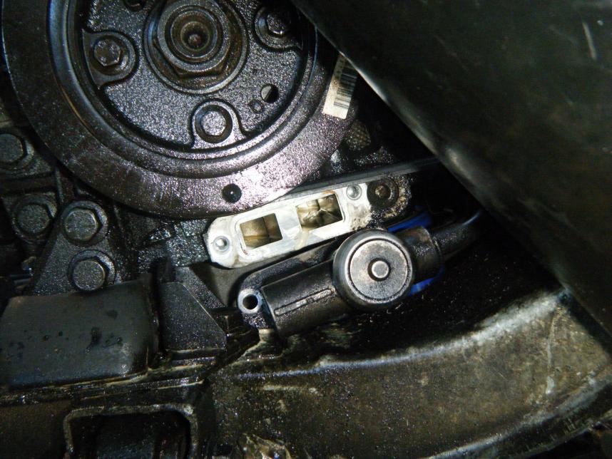

sorry haven't posted up sooner this is what was the problem it was the radiator the oil was not filtering back to the engine and it would build pressure with oil and water mixed in the radiator and cause it to burst out of the water reservoir. it would leave the engine empty. Tech said I could bypass this so I did. I want to the junk yard found an 850 took the radiator and oil cover by the pulley and it works fine now. I changed the head gasket 2 times and it was the RADIATOR all along. I bought the car off craigslist for 550 not bad. I am know in love with VOLVO I know that engine in and out.
Attached Thumbnails milk in my engine-dscf0734.jpg   milk in my engine-dscf0729.jpg   milk in my engine-dscf0731.jpg   milk in my engine-dscf0732.jpg   milk in my engine-dscf0733.jpg
