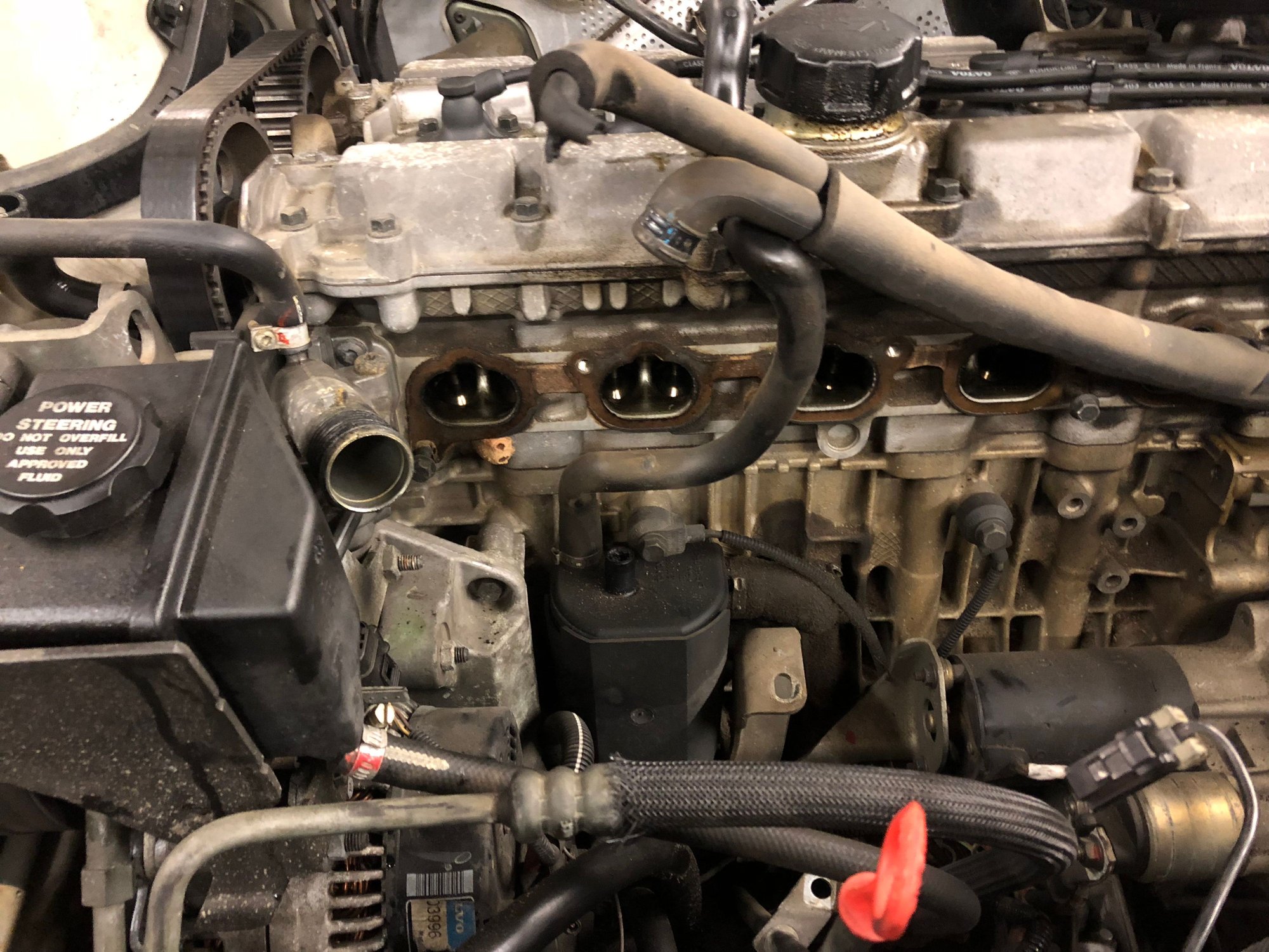

This may seem dumb, but I actually drove the car two years with the bent frame. It runs great, and really is a hoot to drive. I decided this fall to go ahead and replace the frame, and also to do some PM while I had it in the shop. The original frame had the control arm locations bent toward the rear of the car on the passenger's side. It was a minor problem, so really the car drove okay. My maintenance overall was:
  • Timing belt and water pump
  • Motor mounts all around
  • Subframe mounts (I mean, why not)
  • IPD Subframe mount space fillers
  • IPD swaybars (I mean, why not)
  • PCV including dropping the oil pan for cleanout and reassembly with new o-rings
  • OIl cooler line replacement (home-made).
  • A/C clutch removal and shim removal
The junkyards are full of frames, but I am using a '94 frame from a car I had here.
Here are some pics In this first one, you may be able to see that the intake manifold connection had rotted in two. I had some minor idling problems with that and a related check engine light. I suppose the PCV had never been done.
