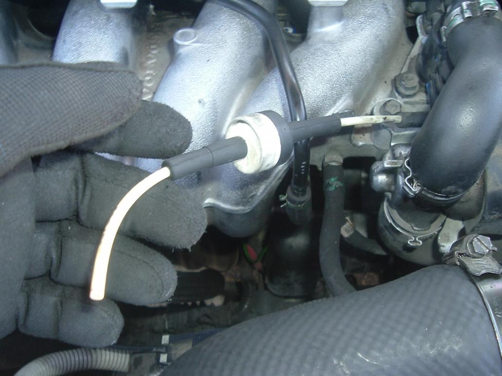

Here's a loose vaccum line, but I don't know where it connects.
just behind your radiator there's a plastic cover that has a valve attached underneath it. pass it under the hose going to the intercooler, then plug & play.
