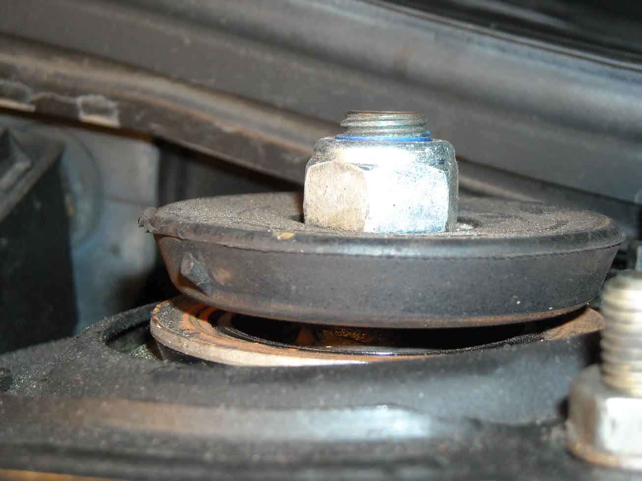

I just changed the struts in my 98 S70, and I have a problem I would appreciate feedback on.
I replaced the stock struts with Bilsteins. In the process I also installed new upper spring seats, bumper stops, and strut mounts. After everything was assembled, I noticed I had a gap between bottom of the top most washer and the mount underneath it. I'm sure this is not correct. But, I have no idea what may have caused this. I was meticulous about assembling everything. The only thing I can think of is I might have installed the funky lock nut with the wings upside down. I've attached a picture.

It is normal to have a space like that.

Also, regarding the gap I started this thread about. Good to know its normal. But can somebody explain why its there? What's the point?

A lot of cars have a gap like that that allows a bit of free play in the upper mount. I'm not sure why it's there on these cars, but I know on VWs it's actually there to change the suspension geometry a little in tight cornering. However, there's so much play in those cars that mechanics who don't know better often freak out and warn of impending doom from badly worn strut mounts... not so on the Volvos, though that play might be for a similar reason.
