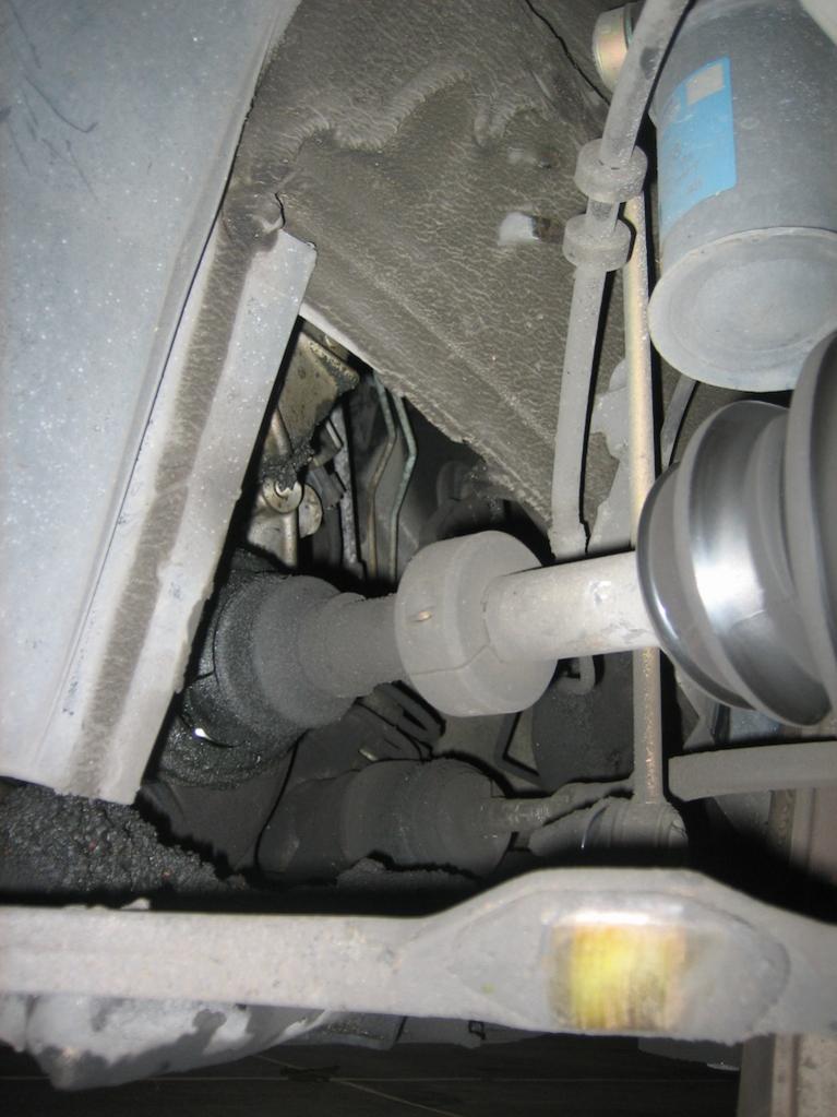

This photo is taken from the driver's side, with the wheel on the right side of the photo. The boot on the left is torn, and I could see all the grease in there.
Should this boot we repaired, or should it just be replaced along with an axle piece?

You would typically just replace the whole axle shaft.

any difference in the $80 vs $110 one? I have a 1998 S70 T5.

Looks like it's just the manufacturer name. One's Empi, the other says Aftermarket. I imagine there is not a huge difference between them.

I've been calling around, and everyone seems to be quoting me 1.5 hours. Does that sound about right?
