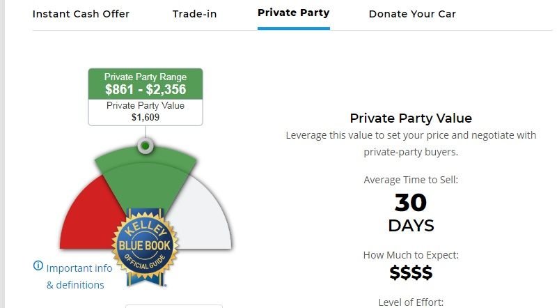

1. If that car is perfect - Not a scratch on the paint, interior smells like new, new tires , not a thing wrong with it visually or mechanically, 2 keys and remotes, never wrecked, with perfect service records, and 210k miles - kelly blue book thinks it's worth $1600. Deduct for any imperfection, - $400 for tires - you get the picture
