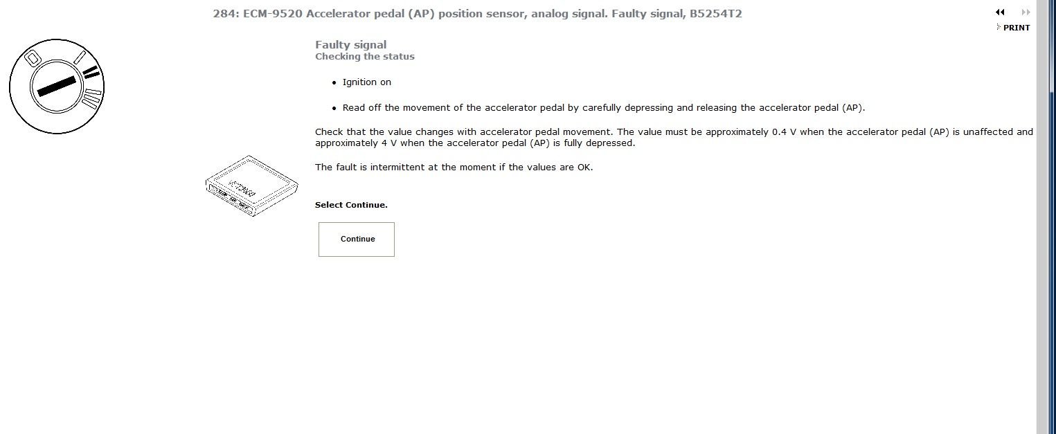

Unfortunately Volvo does not use p-codes, here's a list of throttle/pedal related codes and 2 sample screens of the info you get for a code
Thank you for the info, I will reread codes tomorrow because it’s getting worse and worse every day. I will post what codes it shows me, again I have the iCarsoft scan tool it’s nothing advanced but it WILL read the individual systems I select.
