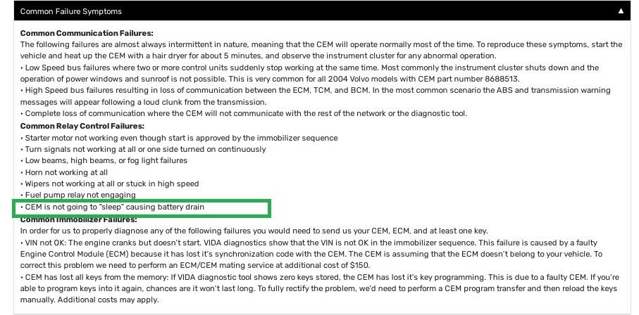

And certainly a battery drain could be caused by the CEM (common symptoms courtesy of xemodex) - that would not necessarily explain your weird noises (unless those only occur right before the battery goes dead - when the voltage is very low)

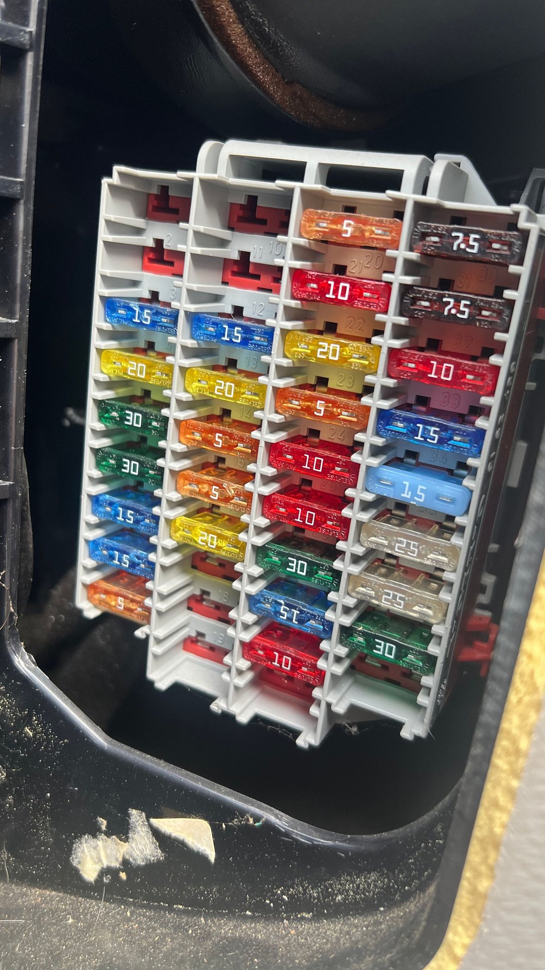

So an update, I tried to do it a lazier way by pulling the fuse for the alarm module - I have a problem there though, the fuse for the alarm module isn't installed.
That's an interesting problem.
Old Jan 26, 2024 | 03:34 PM
Yes fuse 38 is missing - but the siren module is still connected to the CAN network - that signal goes to the sunroof module (if equipped) then to the Uem (in the rear view mirror) - you need to unplug the siren - at the siren.

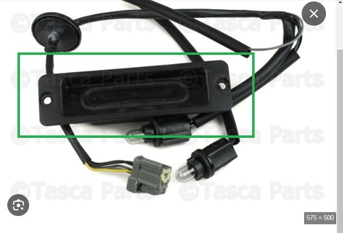

Let me ask - would the faulty alarm module make my sunroof not operate as intended (which is to say not at all) plus prevent my captive touch... thing, on my trunk not work and require a key to open it every time?
Old Jan 26, 2024 | 04:29 PM
1. - would the faulty alarm module make my sunroof not operate as intended (which is to say not at all)
2. plus prevent my captive touch... thing, on my trunk not work and require a key to open it every time?
1. Yes a bad network signal from the Siren module can make the sunroof not function properly.
2. The trunk release usually has a problem - with the switch - under the rectangular rubber pad is a simple microswitch - unless there is a broken wire in the harness that bends with one of the trunk hinges (saw that in many s60s) Do all the other things function back there? (tag lamps, electric lock) Using the key is a purely mechanical way to release the latch.
Yeah, everything else functions as intended except the touchpad to unlock the trunk.
And that's excellent news about the sunroof if it works again once I disconnect the alarm module.
