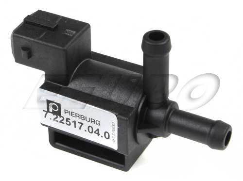

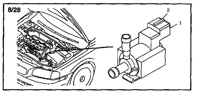

So now I have this part next in line to change, the purge valve, that controls something in the turbo. Any advice? Should I be looking somewhere else?
Another thread I read said something about a metal flap that can get stuck in the turbo?
purge valve location purge valve
