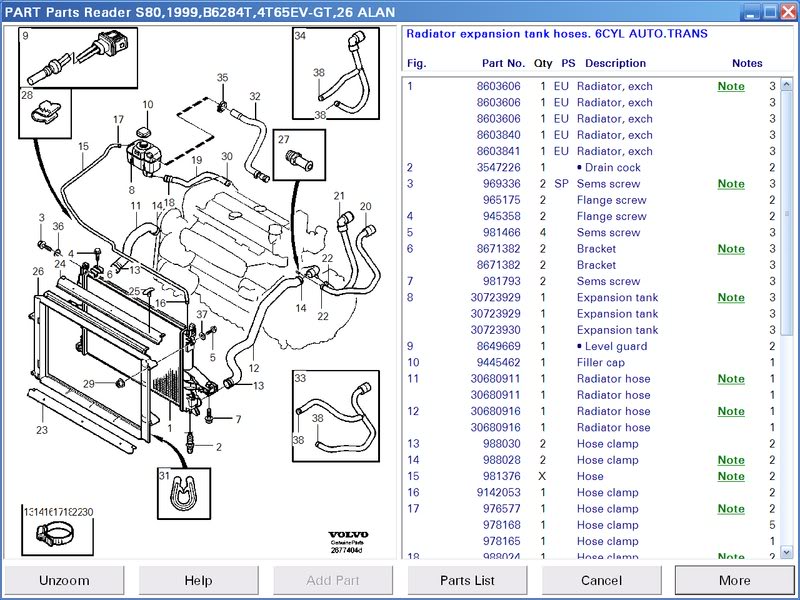

Well the car has now sprung it's 3rd coolant leak, and I am really, really annoyed at it. The coolant was originally leaking from the outlet pipe and this was repaired by a hose. Then I found that the top radiator hose had somehow gotten itself loose and was dripping some coolant, so this was then repaired. Now after a long country drive (and thankfully I got home) before the third leak caused a "Coolant low" warning on the dash. I have jacked the car up and I can not see where this third leak is coming from. While jacked up, I can see that the leak seems to be coming from under the "front" of the engine (ie looking at the engine from east to west not from the front of the car).
It is dripping from what appears to be 3 areas, but then this may just be 1 leak that is being split up when hitting other things on the way down. Does anyone have a diagram of the cooling system so that I can find where this pipe is and fix it?

I have had a chance today to start the car after it has been sitting in the driveway for about 3 days jacked up on stands. The leak seems to be one main leak that looks like it just behind the crossmember right in the middle. Does anyone have a diagram so I can get an idea where and how the culprit pipe sits?
Old Jul 6, 2008 | 09:09 AM
tech's Avatar
Joined: Sep 2004
Posts: 36,349
Likes: 46
Default RE: Another coolant leak - sigh!
Hope this helps.

Thanks Tech for the diagram I am sure it will be of assistance as I try and figure out what exactly has broken or come loose.
