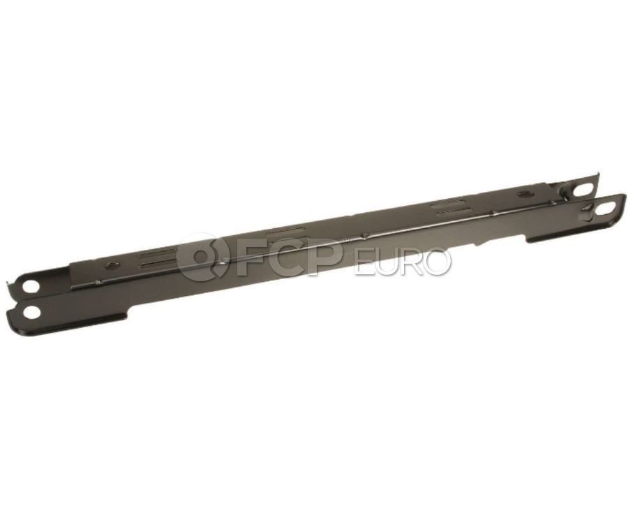

The "stay"s can get easily bent - and change the rear toe making the car unstable - look to see if one of yours is bent. #9200217
