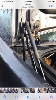

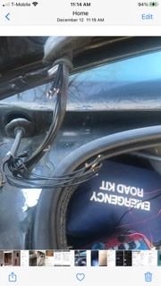

(1) check fuse, if fuse is burned, oil cap won’t open either
(2) press the button at front, if you hear relay noise at glove box, which means button and rekey and fuse are working
(3) if it’s the first time happens, look between rear window and trunk lid on driver’s side. To see if you can see the cable control the trunk. Use a long screwdriver to touch it or wiggle it. Ideally another helper to try opening the trunk at the same time.
(4)if not working, you need open the small window between rear seat. Use a stick to pull the emergency plug to open the trunk
(5) once open the trunk, leave one of back seats unfolded.
(6) cut open the cable yo find out the broken wires. I had 5 out of 8 black wires broken at the same places and at the same time
(7) one wire is thicker. The other 4 are identical, so I labeled one end as 1,2,3 and 4; the other end labeled as a,b,c,d. I know there are 24 combinations. I tried one by one, I got it working until the 6th try.
(8) make sure lights are off when trunk is closed.
