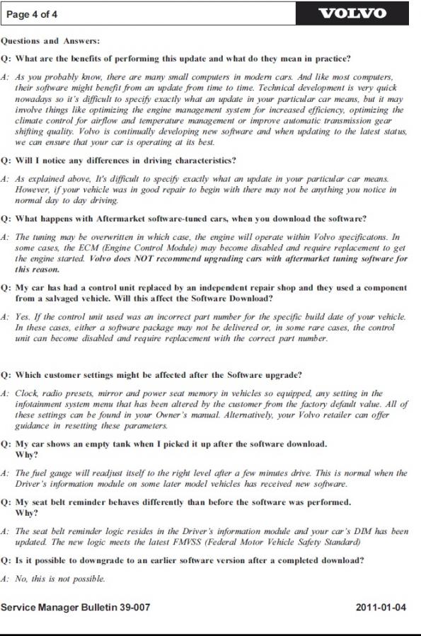

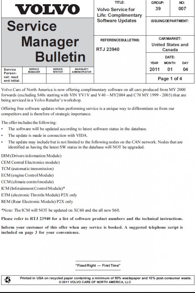

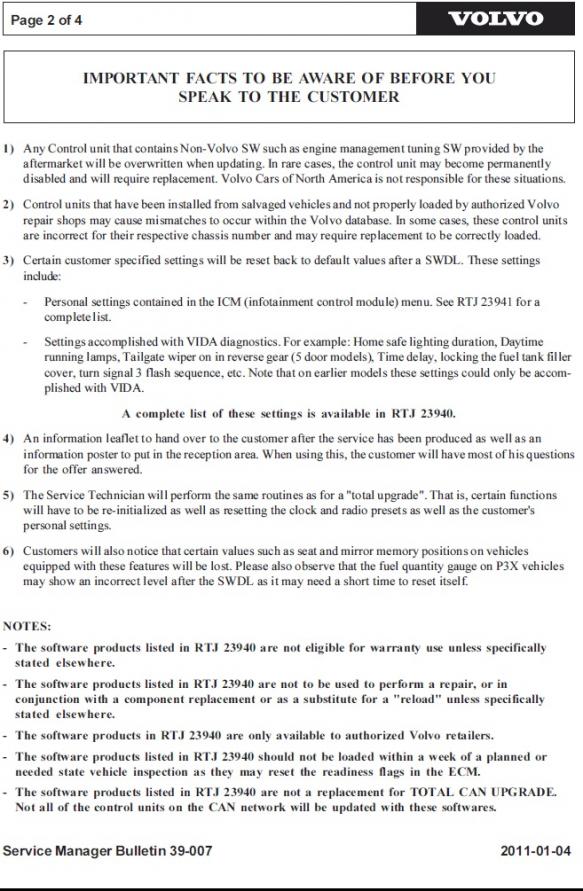

Check this out!!!!.. now the dealer offers complementary service upgrade for 2000 year models and up . But that is only if you go to them for some service like oil change, etc. I think this is great. Here is full report of it. You will have to open these files in new window for better zoom in

Have you tired this? Is there a way to verify if the program is still be honored by the dealers off NA.?

no i havent tried this but i will on my next service maintenance schedule. But i did call the dealer and they said it can be done but only when you come in for service due. like oil change or any kind of service.
you could call and ask them about this
